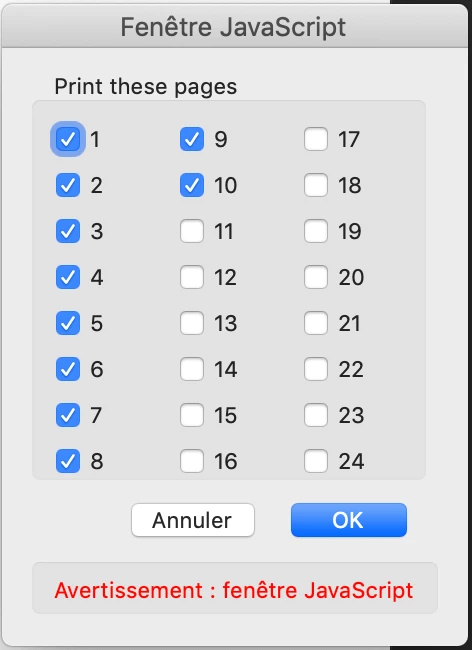

Here is the adaptation of a script I did a few days ago for an other forum.
When you click on the "Print" button, you will get a dialog box where you can choose the pages to print.
This dialog box is done for a 24-page document and must be adapted in accordance with the number of pages of yours. In this example the ten first check boxes of the dialog box are ticked by default.
The printing script line is disabled, so don't forget to remove the 2 slashs for enabling it (must be: this.print(pp);).
Hope this will suit you.
