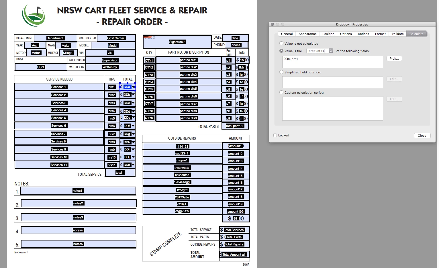

I have 11 fields that are setup to multiply from field a, to field b. This is a very basic calculation (Dropdowna, hrs1), (Dropdownb, hrs2) and so on. They calculate just fine with inputting data, but when data is changed or added to any other part of the form, the amounts are somehow added to these very basic calculations as a new total and they seem to continue to multiply, producing incorrect results. Any ideas? I'm having major issues here with what should be a very simple task. Calculations are shown in the "Services Needed" columns in the attached image. Thanks in advance!

Yes. It is a dropdown which is selected, and then multiplied by another value (hrs multiplied by service requested). What am I missing?
It doesn't make sense. Each time the calculation takes place (which happens each time any field in the file is changed) it will become exponentially bigger.
Your formula is basically: X = X * Y
So if at first X is 1 and Y is 2 the result is 2, but then it will be 4 (2 * 2), 8 (4 * 2), 16 (8 * 2), etc.
You can't include the value of a field in its own calculation. That's circular logic.

How did you set up the calculations? Did you use a script? If so, post your code. If not, please describe what you did.

I did not use a script. I named the fields, each with a different name of course, and then went to properties, calculate and selected "product (x" from the value is radio button, and then selected the two relevant fields using the "pick" feature. Please see attached.

So the value of the field is its own value multiplied by another field's value? Don't you see the problem there?
