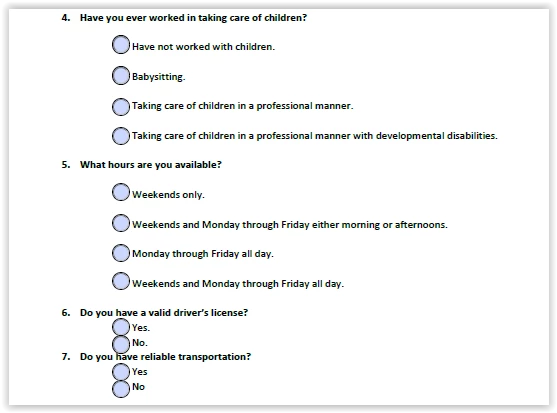

SUM radio button values
I have a simple form with some radio buttons, and I'd like to create a formula to extract the values of the radio buttons and add them and/or average them. I've attached a picture of the document I'm working on. Keep in mind I'm a complete novice I'm just trying to learn some new skills.

If you apply the values as the "radio button choice" value of each field (under Properties - Options) then you'll be able to use the built-in calculation commands to do these operations.
Mar 16, 2016 3:47 PM UTC
Where would these built-in calculations be displayed? or how do I make them displayed?
I've set the value as a numeric value I just don't know how to get the sum of the values selected.
try67
Mar 16, 2016 4:40 PM UTC
Where the result would be displayed? I had assumed you created a text field for it... If not then you should, and you'll find the calculation options under its Properties - Calculate tab.
