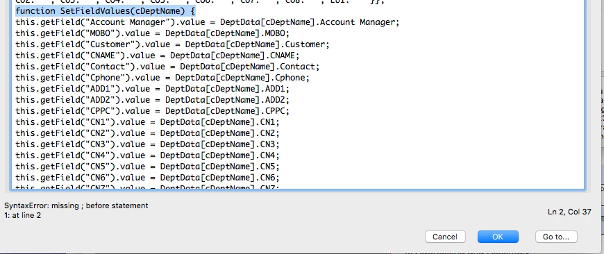

ElyRossAuthor
Jul 17, 2019 3:19 PM UTC
great, thank you!... i have updated all of these... i now i have an error as below:
it appears there is a ; mark before... but im still missing something...
again, i really appreciate the feedback!.. thank you so much!
try67
Jul 17, 2019 3:22 PM UTC
You can't include spaces in the names of the variables in your data model.
try67
Jul 17, 2019 3:25 PM UTC
PS. In the future please post your code as text, not as an image.
