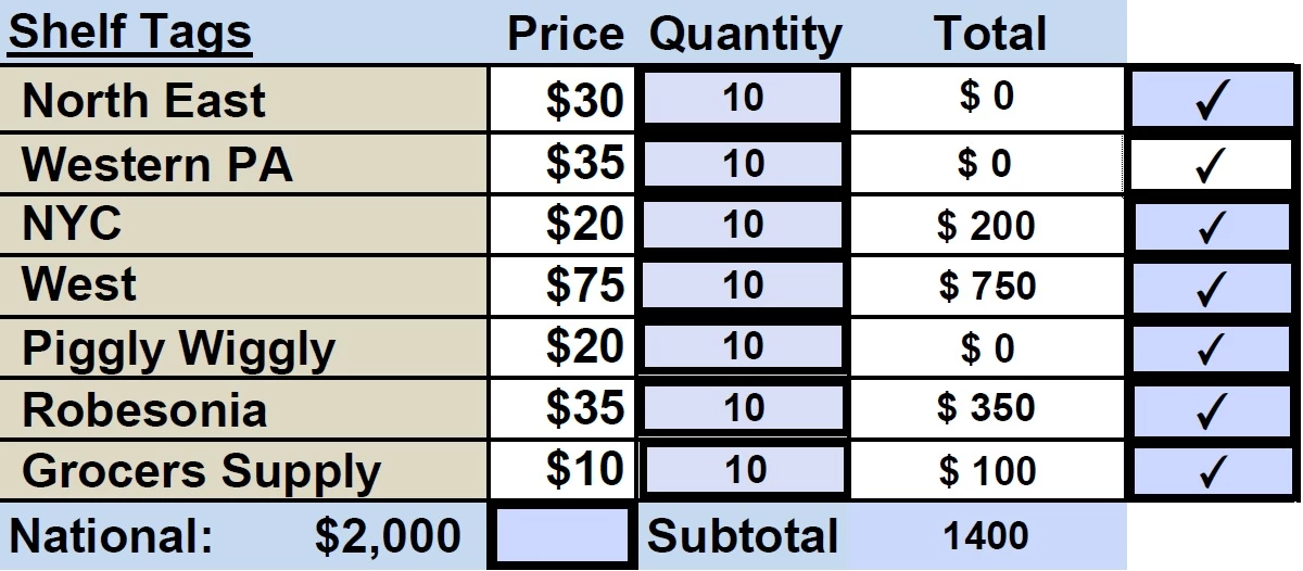

Hi, I have minumal experience in Java/coding, but understand the basics due to some programming classes I've taken in the past. I'm making an order form that a customer can change the quantity entered and add it to their order with a Checkbox. There is a suggested quantity that will already be entered. I have managed to create multiple Text fields with a script to calculate the price(Total) that is activated by a Checkbox. Next to each Text field is the Checkbox that turns the field "Off" or "On". It works fine with one, but I have 7 and each time I enter a new calualation in a new, unrelated field, it randomely cancels out the some of fields above it. See below. All are checked, so all should have the Total price entered.

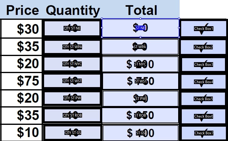

I was originally using these scripts in each of the Total Text fields.
  1. event.target.value=this.getField("QTY ST NE").value*30; event.value = 0;(this.getField("Check Box1").value!="On")
  2. event.target.value=this.getField("QTY ST WPA").value*35; event.value = 0;(this.getField("Check Box2").value!="On")
  3. event.target.value=this.getField("QTY ST NYC").value*20; event.value = 0;(this.getField("Check Box3").value!="On")
  4. event.target.value=this.getField("QTY ST WST").value*75; event.value = 0;(this.getField("Check Box4").value!="On")
  5. event.target.value=this.getField("QTY ST PW").value*20; event.value = 0;(this.getField("Check Box5").value!="On")
  6. event.target.value=this.getField("QTY ST ROB").value*35; event.value = 0;(this.getField("Check Box6").value!="On")
  7. event.target.value=this.getField("QTY ST GS").value*10; event.value = 0;(this.getField("Check Box7").value!="On")
