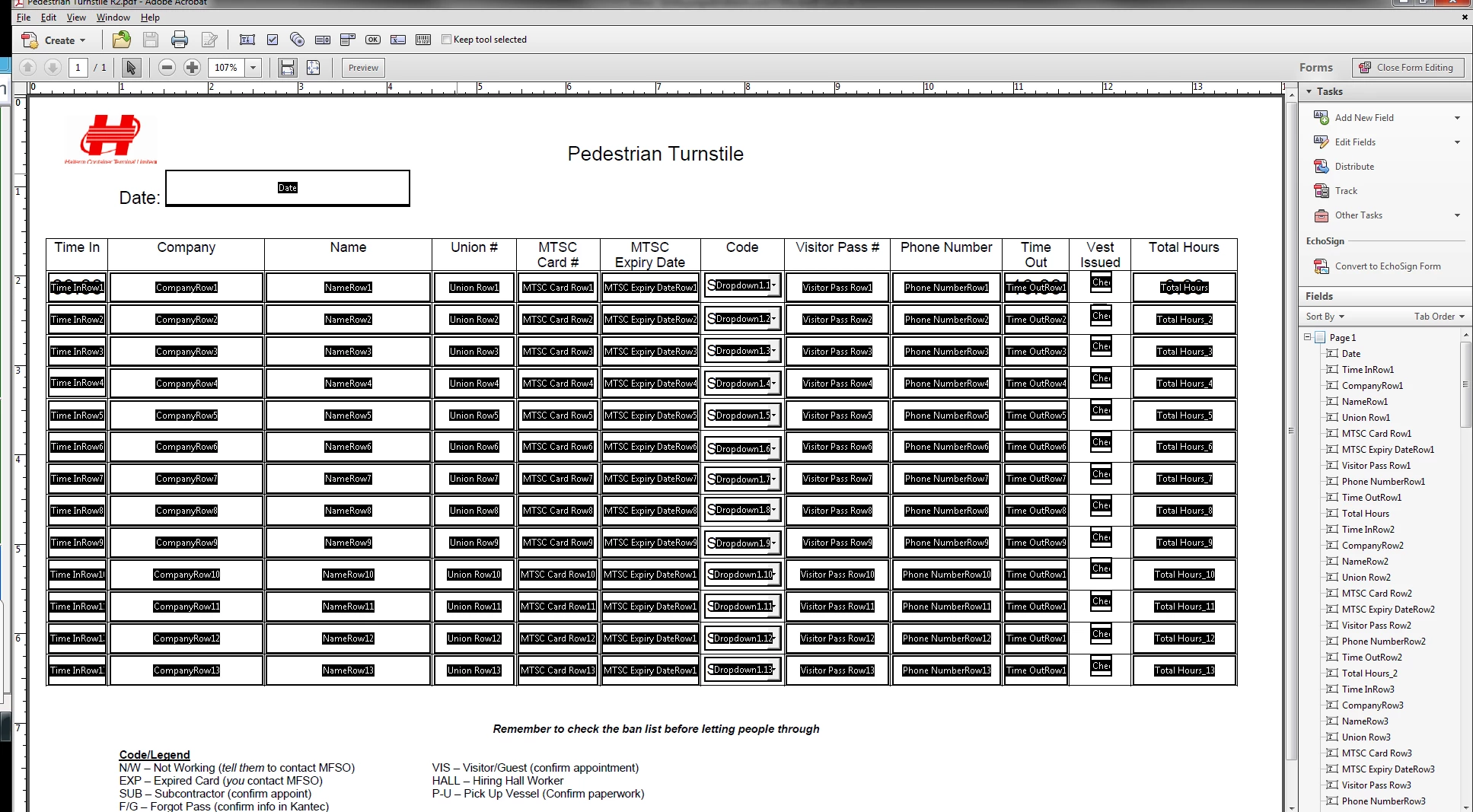

I need help calculating the duration between Time in and Time out
August 5, 2016
Thanks - I was working off of the tutorials above, but my total keeps at 0.  I think I am missing a step
Here is my script.  The two field that I need pulled from are Time In and Time Out
var strStart = this.getField("Time InRow1").value;
var strEnd = this.getField("Time OutRow1").value;

First of all, I would check that both fields are filled in before proceeding with the calculation, not either one. So change the OR operator (||) in the first if-condition to an AND operator (&&).
Also, I would add an else statement, to reset the field in case that condition is not met.
And I don't quite understand why you have an additional declaration of the strStart variable and an additional if-statement to check whether it's empty. You don't need those.
I would also recommend that you enable the option to show the JS Console on warnings and errors (under Edit - Prefs. - JavaScript). It will help you find problems with your code as they happen.
