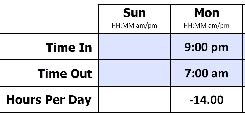

Yes I know this question has been asked many times but I have looked through dozens of examples and a lot of the "Sample" forms in the forums are no longer available since Adobe has changed stuff around. I have attached the form. I need it set up where time is not given in negative numbers for example if a person works from 9:00 pm to 7:00 am. It needs to display 10 hours instead of -14 hours (as it currently gives me). I appreciate the help! There are no "breaks" or "lunches" etc. in this. Just a calculation between the Time In and Time Out.
Thanks!

In TimeDiff, after this line:
var fEnd = Time2Num(sTimeFormat, sEnd);
Add this:
if (fEnd<fStart) fEnd+=86400;

For future purposes for anyone here is the code:
Document Level Javascripts:
function Time2Num(sFormat, sTime) {
if(sTime == '') return ''; // exit
// get date time for Epoch date and sTime
var oTime = util.scand('mm/dd/yyyy ' + sFormat, '01/01/1970 ' + sTime);
// convert UTC Offset to milliseonds for adjustment
var fTZOffset = oTime.getTimezoneOffset() * 1000 * 60
// time since the start of the day in millseconds
var fTime = oTime.valueOf() - fTZOffset;
// convert to seconds and return value
return Math.round(fTime / 1000);
function TimeDiff(cStartField, cEndField) {
var sTimeFormat = 'hh:mm';
var fDiff = 0;
// get the start time
var sStart = this.getField(cStartField).value;
// get the end time
var sEnd = this.getField(cEndField).value;
// complete script only if we have data
if(sStart != '' & sEnd != '') {
// convert sStart string to seconds
var fStart = Time2Num(sTimeFormat, sStart);
// convert sEnd string to seconds
// compute difference in seconds
fDiff += fEnd - fStart;
return fDiff;
In the Custom Calculation Script
(this goes in the field that will calculate the difference between Time In field and Time Out field..swap out SundayIn and SundayOut for your field names):
event.value = '';
var fDiff = 0;
// compute the difference for first pair of fields
var sStart = this.getField('SundayIn').value;
// get the end time
var sEnd = this.getField('SundayOut').value;
var fStart = Time2Num('hh:mm', sStart);
var fEnd = Time2Num('hh:mm', sEnd);
fDiff = TimeDiff('SundayIn', 'SundayOut');
// convert to rounded minutes if not zero
if (fDiff != 0) {
fDiff = Math.round(fDiff / 60);
// report decimal hours
event.value = fDiff / 60;
