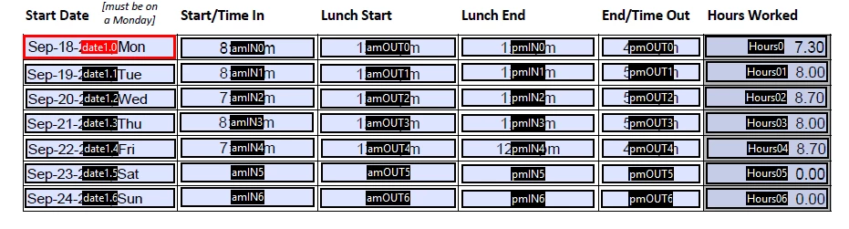

I have four fields [amIN0, amOUT0, pmIN0, and pmOUT0] that will auto-populate the Hours Worked field.
My times are formatted to h:MM tt.
I need the HoursWorked results to display 7 hours and 30 minutes as 7.50 NOT 7.30
And 8 hours and 30 minutes should display as 8.50 NOT 8.70
I'm using a simplified notation (amOUT0-amIN0)+(pmOUT0-pmIN0).
Please help. Thank you.

You can't do it like that. Time calculations are much more complex than normal math calculations, and require a custom-made script.
There are good tutorials about this subject here:
https://acrobatusers.com/tutorials/working-with-date-and-time-in-acrobat-javascript
https://acrobatusers.com/tutorials/working-with-date-and-time-in-acrobat-javascript-part-2
https://acrobatusers.com/tutorials/working-with-date-and-time-in-acrobat-javascript-part-3
Alternatively, if you don't want to write the code yourself, I've developed a tool that allows you to easily set up this kind of calculation, including the option to show the result in decimal format (ie, 2.5 for two and a half hours, instead of 2:30): Custom-made Adobe Scripts: Acrobat -- Calculate Time Differences in a Worksheet
