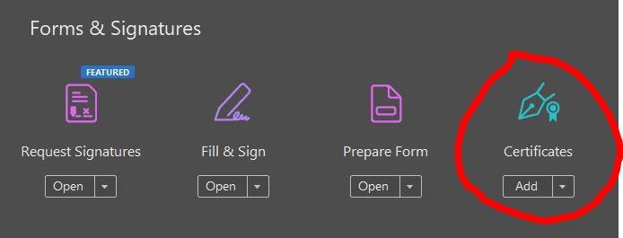

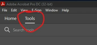

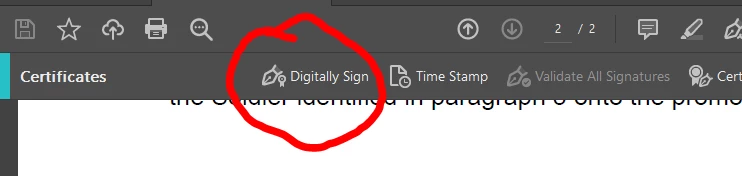

Jan 12, 2022 7:47 PM UTC
These are the instructions for Adobe Acrobat Pro DC as of 20220112.
1. From the menu bar select the Tools tab (next to the Home tab).
2. Scroll down until you see Forms & Signatures.
3. Select Certificiates.
Note. Selecting Add will add the shortcut to the Tools Pane. Click and drag the shortcut to the top of the Tools Pane for faster access to this feature.
4. The Certificates tool bar should now be visible on the document you want to sign. Select Digitally Sign.
5. Follow the instructions from there.
Note. To create an empty signature field, sign the document first following the steps above, right-mouse-click on the signature and select Clear Signature, and save the document.
