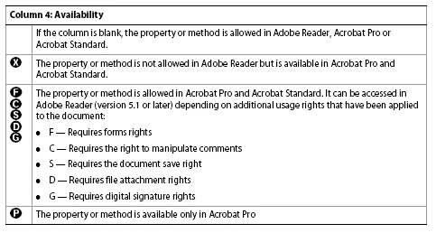

Reader can not edit PDF files. You can't use movePage in it. This is clearly stated in the JS Reference in the form of an "X" in the fourth column under the function's name:
alexisr96992484
September 1, 2016
OK, then it confirms that I cannot use the movepage function. Thanks.
