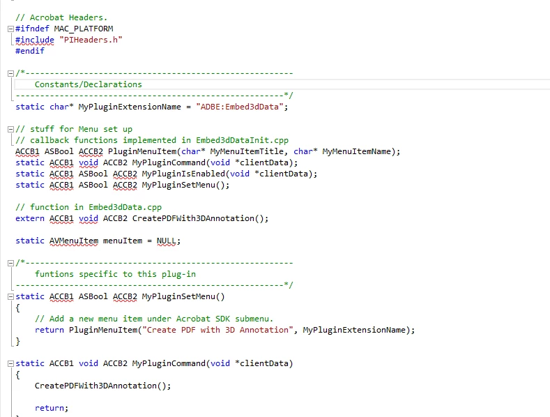

I am trying to use the Embed3dData plugin on Adobe Acrobat DC.
However, most of the objects are simply undefined...
I tried downgrading my Visual Studio 2015 to 2013, and still, no change...
Thank you!!!

Bernd, yes, I get a compile error.
I can edit the AcroDspOptions text file:
/D ACRO_SDK_LEVEL=0x000A0000
/D PI_ACROCOLOR_VERSION=0x00060000
/D PDMETADATA_HFT=1
/D PLUGIN=1
/D ACRO_SDK_PLUGIN_SAMPLE=1
/I "."  --line 1
/I "..\sources" --line 2
/I "..\..\..\Headers\API" --line 3
/I "..\..\..\Headers\SDK"--line 4
/I "..\..\..\..\XMP_SDK\MetadataToolkit\Headers" --line 5
Does the file tell the compiler where the files are? If the answer is yes, how does the compiler know how to find this text file, but not the header files??
I dont understand what am I supposed to edit. What is the purpose of the first part which start with /D?
In the second part, whose lines I've numbered, do I need to replace the pathes?
What is the meaning of the /D and the /I?
And which folders are lines 1,2,5 referring?

July 1, 2017
Thanks! And how do I tell the compiler where to find the headers?
Bernd Alheit
July 1, 2017
in the file "AcroDspOptions".
Did you get any error message when you compile Embed3dData.cpp ?
Bernd Alheit
July 1, 2017
Looks like that the compiler can't find the header files.
July 1, 2017
They are included in the solution.
Bernd Alheit
July 1, 2017
What error messages do you get?
