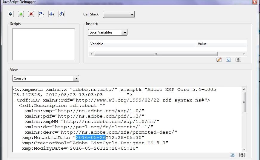

We are trying to bring out the version control to the forms using the latest checked in tfs Date and we found that this date is captured in the Metadata (XMP File) of the form.
We are able to view the Metadata from Adobe Reader by placing the attached '.js' file ShowXMPData.js in the path "C:\Program Files (x86)\Adobe\Reader 11.0\Reader\Javascripts" . Attached screenshot for your reference.

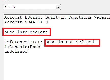

Do not use "this" in the console. I have said, use it only in events.
June 8, 2016
I see your calling code is referring to "this". So in what event do you use that calling code? Context is important. Also, does the message really say "oDOC" or does it say "oDoc"? Did you copy/paste this code, or retype it for the post?

I have used 'oDoc'. Below is the error pop up during debugging

I am calling this code in 'Initialize' event in adobe designer

Don't use "this". Just forget it exists except in event handlers. Find another way to reference the document for which you want to receive this information.

I tried the below code 'oDoc.info.ModDate;' as mentioned, but it is showing as "'oDOC' is not defined" Kindly help.

(1) Your problem may be the use of the object "this". The meaning of "this" depends on the context (see the JavaScriptAPI Reference). Use it in events. Never use it in startup scripts. Recode to avoid.  I have no comment on whether the code is otherwise correct, since we cannot know what you even intended "this" to be. When showing a startup script please also show calling code and tell us which event is used.
(2) It looks as if XMLData is documented, though following it in full needs to follow the references to other documents - please clartify where the documentation needs clarification. You will certainly need to know the XMP schema.

I have attached the screen shot and also Below is the js code which we place in the below path.
app.addMenuItem({ cName: "ShowXMPData", cUser: "Show XMP Data", cParent: "Edit",
    cExec: "console.show(); console.clear(); console.println(this.metadata);", cEnable: "event.rc = (event.target!=null);"});

try67
June 2, 2016
I don't understand what's the issue. Your code works fine. It opens the console window and displays the file's XMP metadata.
What else do you want it to do?
