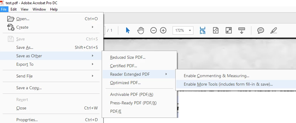

catsgotmytongue
December 7, 2016
Please elaborate on what this means, I have never developed for adobe acrobat before.
Where can I find the documentation that explains the steps involved in applying these rights to a pdf?
I find no such "Save as Rights enabled" any where in acrobat DC Pro's menus or preferences or save as dialogs the closest I find is this:
I've tried this several different ways and I cannot get the method Net.HTTP.request to execute at all with acrobat pro or reader DC or XI in my javascript extension code.
Clearly I'm doing something wrong if it won't execute that method.
However, there must be some set of circumstances or steps on how to apply these rights I'm missing. The documentation isn't very clear on this particular aspect.
