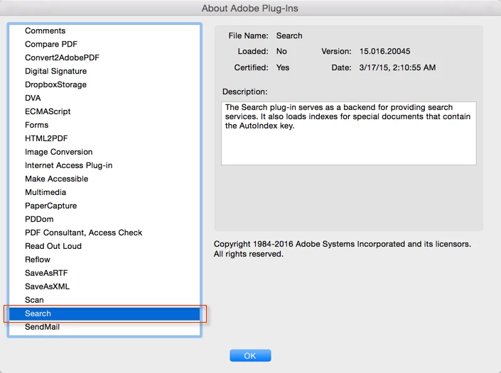

Just to expand on Bernd's answer, when you go to "Adobe Acrobat>About Adobe Plug-ins" on a Mac, or "Help>About Adobe Plug-ins" on Windows, you will get a list of all installed plug-ins from Adobe:
You cannot search in Acrobat without that plug-in being present and active. It does not matter if you are using search/find from the user interface of the AVApp.FindText method from the IAC API, it's always the search plug-in that does the actual work. I understand that you are not satisfied with what the FindText method is providing, because the user interface allows you to do a lot more, but unfortunately, that's the only API function we have in the IAC API to search. Unfortunately, there is also nothing in the Javascript API, otherwise you could use the JSObject to access JavaScript functionality, but that does not help in this case either.

But I'm still stuck.  BTW, it's Help->About Adobe Plugins..., not File->About Adobe Plugins.  Maybe I was confused here because it says "Not Loaded" in the about dialog.  So, I guess it is installed, but I still don't know how to load it.  I've got the full API document, but nothing in it tells me what file to reference, how to create the search object, or how to browse the classes, etc..  Let me give you an example using VBA:
