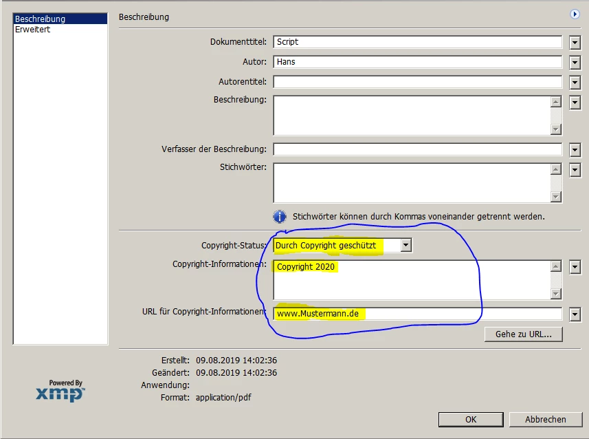

Why does not the script work
My question, why is the following script not running within the "Additional Metadata"? Entries in the document properties, e.g. Title, author, etc. work with it.
The script:
function CopyrightStatusSetzen(){
var EingabemdCopyrightStatus = app.response({
cQuestion: "Geben Sie die CopyrightStatus ein:",
cCopyrightStatus: "CopyrightStatus eingeben",
cDefault: "1975"});
if(EingabemdCopyrightStatus == null){
else
this.info.CopyrightStatus = EingabemdCopyrightStatus;
this.layout = "MultiplePage";
// this.layout = "SinglePage";
app.addToolButton({
cName: "SetCopyrightStatus",
cLabel: "CopyrightStatus setzen",
cTooltext: "CopyrightStatus setzen",
cEnable: true,
cExec: "CopyrightStatusSetzen()"});
could someone help me?
System: Windows 7; Acrobat DC
Thank you and best regards

Aug 9, 2019 1:44 PM UTC
What app is that? Looks like it may be a separate general XMP viewer. If so, it won't be looking at PDF/X metadata...

Aug 9, 2019 12:08 PM UTC
It should appear here:
Aug 9, 2019 3:12 PM UTC
You should notice that the data is in the XML format and that is what needs to be edited. This property was added in Acrobat 7.0 and one needs to use the XMLData object and the XMLData.parse method.

Aug 9, 2019 11:40 AM UTC
Hello try67,
yes that's true, but I need the input in the document properties in the field as described: Description (additional metadata) and that does not seem to work ?!
Many thanks
try67
Aug 9, 2019 11:56 AM UTC
I don't quite understand where you want it to appear...

Aug 9, 2019 11:15 AM UTC
Hi try67,
yes that's right, but I need the entries in the Description tab (Additional metadata), and that does not seem to be that easy or impossible?
Love from
try67
Aug 9, 2019 11:26 AM UTC
Ah no, there you can only use the built-in properties, not ones that you've added yourself.
try67
Aug 9, 2019 11:28 AM UTC
Actually, that's not quite true... If you go to Properties - Description - Additional Metadata - Advanced and expand the last item in the list, you'll see your custom properties:
Aug 9, 2019 7:55 AM UTC
It means your code cannot work, and to update additional metadata requires a lot of study and development.
I recommend studying the PDF Specification, ISO 32000-1, to understand the different types of metadata. This may lead into study of XML in general and XFA metadata. Then you would need to update the XML metadata somehow.
So I do not say it is impossible. But you may not have the time or resources to do it.

Aug 9, 2019 7:29 AM UTC
Doc.info sets fields in the Info dictionary, as documented. Additional metadata is not stored there, or displayed. You can set extra fields in the Info dictionary but it won’t be merged into metadata. Standard names are automatically merged into the XML metadata, which you can read and write as a packet using Doc.metadata.
Aug 9, 2019 7:50 AM UTC
Thank you for your answer, but what does that mean? Is it not possible to insert data in the "additional metadata"?
Thanks
Bernd Alheit
Aug 9, 2019 7:26 AM UTC
I miss a { after else.
Aug 9, 2019 7:47 AM UTC
If I add one more I get a SyntaxError 15 in line 16
