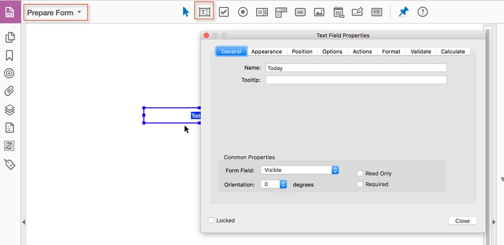

Where do you see "Common properties"? Your text field needs no special properties, just create it in the forms editor ("Prepare Form").
Just make sure that you select "Format" to "None". Then use the script that was already provided as your "Document Will Print" action. Make sure that the field name is spelled the same way in both the field's properties and the script.

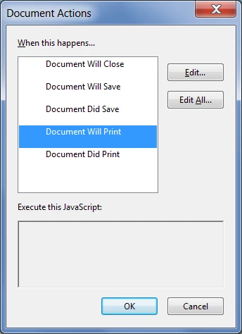

Now go to Tools and search for "document actions". Click on the item found (called "Set Document Actions") and you'll see something like this:
Select the Document Will Print item and click on Edit.
In the window that opens paste this code and then press OK:
this.getField("Today").value = util.printd("mm/dd/yyyy", new Date());
That's it, pretty much. Save the file and the next time you print it the field will be populated automatically.
