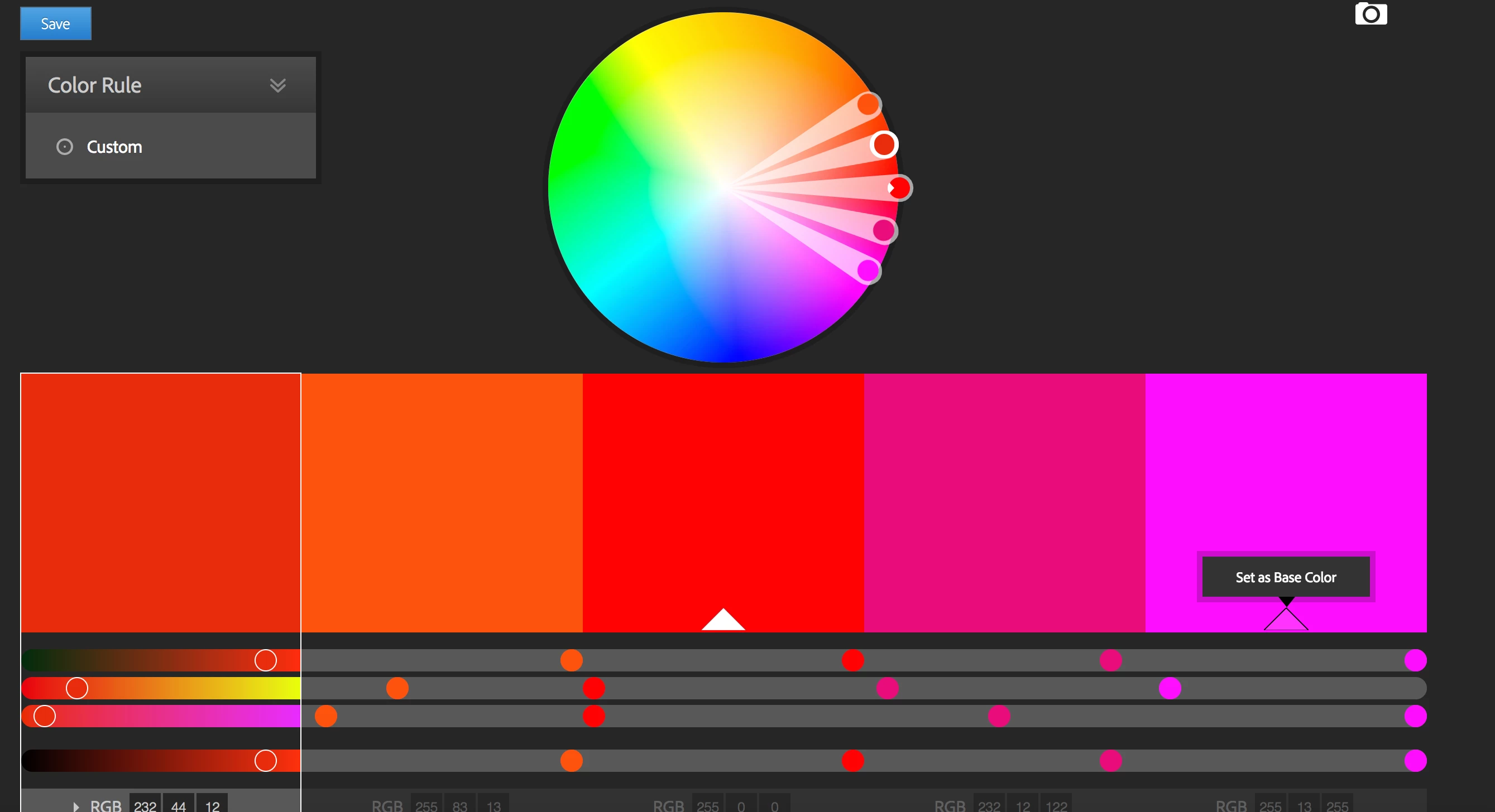

1. Hover over a swatch, for eg:- pink color as depicted in below attachment, and you will observe a small triangle appear at bottom of  t
    that swatch.
2. Hover over that swatch, and you will observe alternate text "Set as base color"
3. Click on that small triangle, your base color will change to new swatch.
4. Which can be confirmed by white filled triangle.
If you still face any issues, then reply back with your feedback, along with images/attachments of what you are observing.

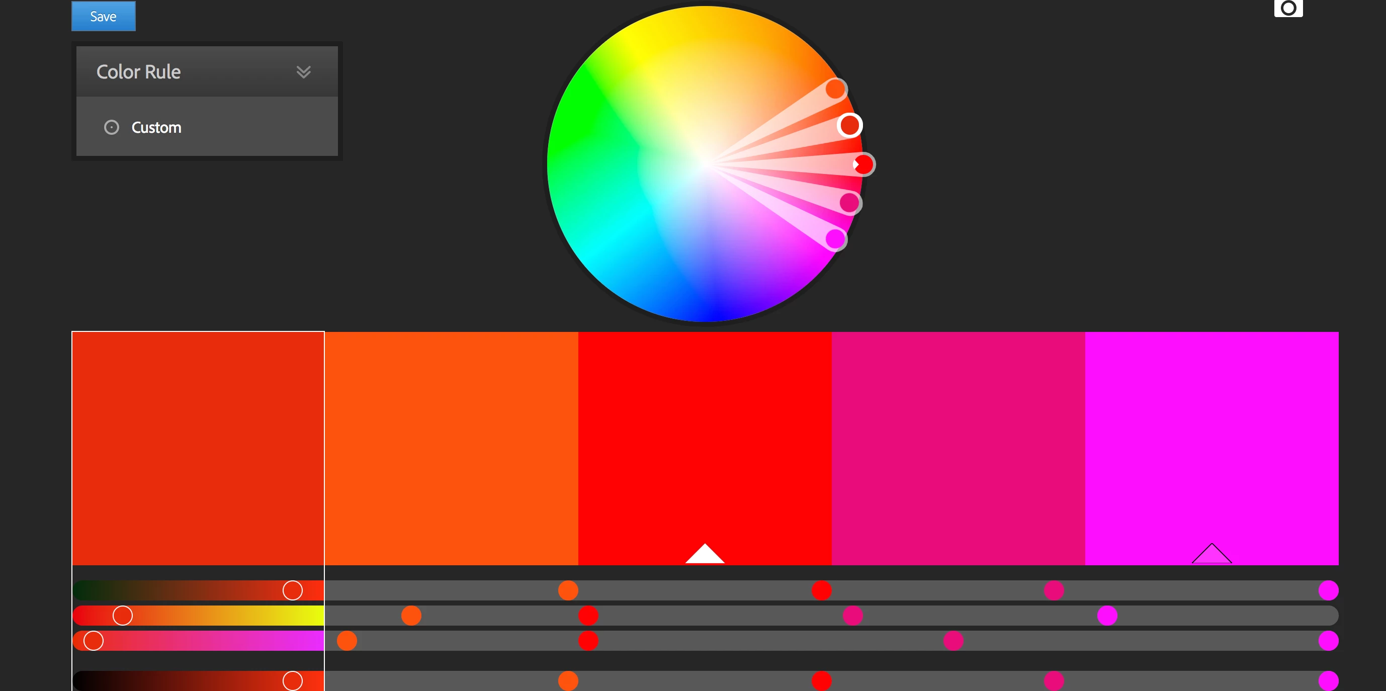

Jan 9, 2018 10:31 PM UTC
That is my problem. I hover over one of the other colors and do NOT see the triangle and the "set as base color" text. I have tried this on both Google Chrome as well as Firefox browsers. Any ideas that you might have would be appreciated.
