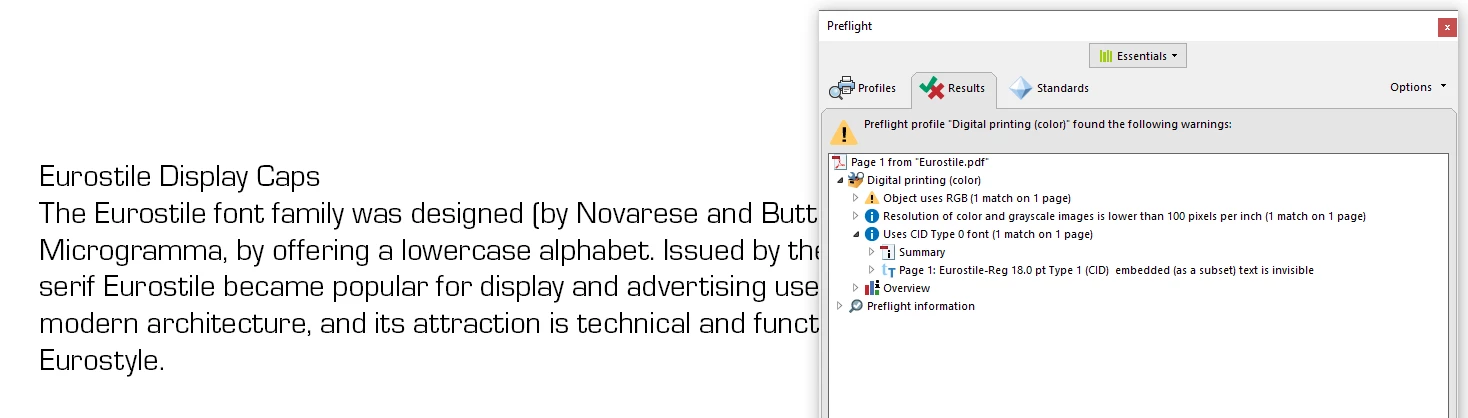

Hi @emmak94013664, I had this same question with Adobe Jenson Pro. It is an Adobe CC font activated through my account. Jenson is an Open Type font, but when I looked at the PDF preflight analysis in a book using this font, Jenson shows up as a Type 1 font. This is the same thing with Eurostile as you can see here in my test with it. I looked through the documentation on Eurostile at the foundry, and I can't determine what font type it is. It took me a lot of digging to get that info on Jenson.
AFAIK, if these fonts are not directly installed on your local computer system or network, and you are using them as activated through your CC subscription, then they are embeddable and fine to use under the license. However, why they show up as Type 1 fonts in preflight is a mystery. I am wondering if it will come back to haunt us, as I understand the trend is to move more towards renting fonts based on application.
Here is how Jenson shows as Type 1 in preflight, compared to other TrueType fonts in the document that are installed on my system.
