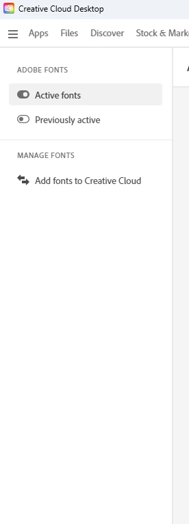

    the way I like best is going to the CC app
    choose "manage fonts" in the left panel:
    Then go to active fonts and deactivate them as you wish by going to active fonts.
    You can even reactivate previously deactivated ones by going to "previously active" and re-activate from there.

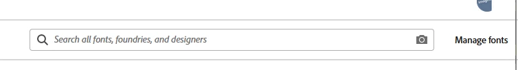

    Obviously you can also go directly on Adobe fonts:
    and go to manage fonts
    On the top right side of the window...
