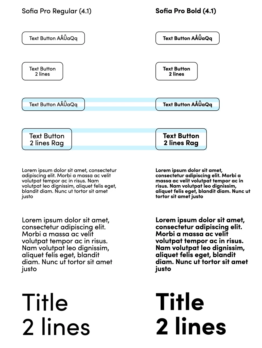

im embedding my font Sofia Pro using Adobe fonts on my Bootstrap 4 website.
Now, i've came to the harsh conclussion that Adobe does not correctly align the webfont inside the line-height.
See examples:
What this means: using flex-box align center (which aligns items in the real center of a plane) the objects are not visually centered with the text, because Adobe messed up the placement of the font inside the line-height.
I cant use margin-top: -1px on ALL the items to fix this problem. Which would result in a lot of css selectors.
Please fix the font. I've seen this problem before creating webfonts. It has usually something to do with the compression and placement of pixels which lowers the font inside the line-height.
Please fix 🙂 thank you.

    I contacted the type foundry over Twitter. they got back with good news.
    "Hi Matías. I have made new line-height for Sofia Pro Below a test with buttons with one line and 2 lines."
    I haven't tested the font yet as I ended up downloading it from myfonts.com. ¿Can anyone confirm the new line height is working when serving Sofia Pro from Adobe? Thanks

    I'm facing the same issue and can confirm it is NOT fixed yet in Adobe, even though the creator of the font files updated the fonts over a year ago.
