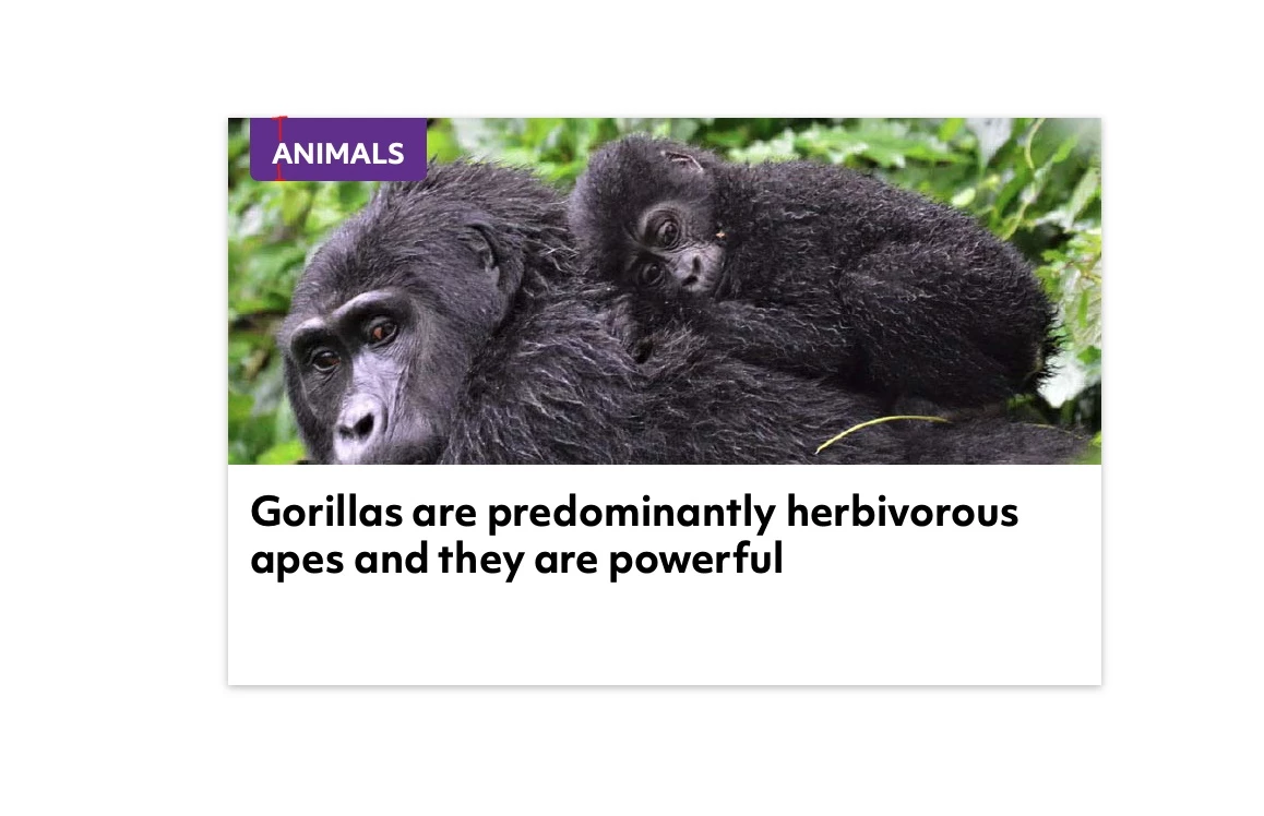

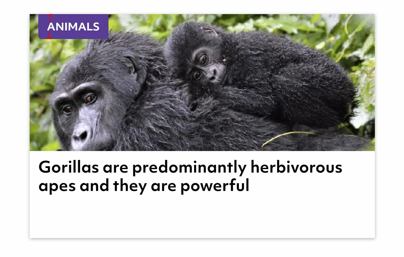

I checked it and there is a difference where the font baseline is, making the page look very different and not aligned between those two OS's if I set it right on WIN10 then MAC looks off and vice-versa.
see images below: (both on chrome)
Top image - Win10 correct alignment
bottom image - Mac OS to low
How can I solve it my project is now stuck I based it on this font and I can't show it to my client with this kind of difference

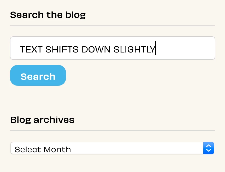

I have the exact same issue with the "Obviously" font - now the visuals are approved and we're building the site there is a notable baseline shift going on. Pulldowns have the text slightly lower than it should be, form fields are off, buttons are off too. Is there a work around for this?
