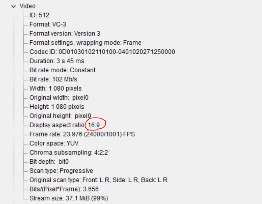

1:1 MXF OP1a/DNxHR-HQx flagged with 16:9 Display Aspect Ratio metadata
Sending render job out of AE to AME.  Comp is 1080x1080 square for Insta.  Have selected DNxHR MXF-Op1a format option, and using the resolution independent flavor of DNxHR-HQx.
Inspecting the file in MediaInfo.app I can see the metadata says the display aspect ratio of the .mxf is 16:9 (wrong!).
Ingesting the file into various apps for QC yields different, and inconsistent results.  Sometimes it looks correct with 1:1 square aspect ratio, other times it adheres to the 16:9 flag and stretches.  The .xmp file produced by AME at the same time as the .mxf must be in the same folder to have the media interpreted correctly 100% of the time. Presumably the line {xmpDM:videoPixelAspectRatio="1/1"} is what alerts the video players (and/or AME on re-ingest) that the video is to be interpreted as square.

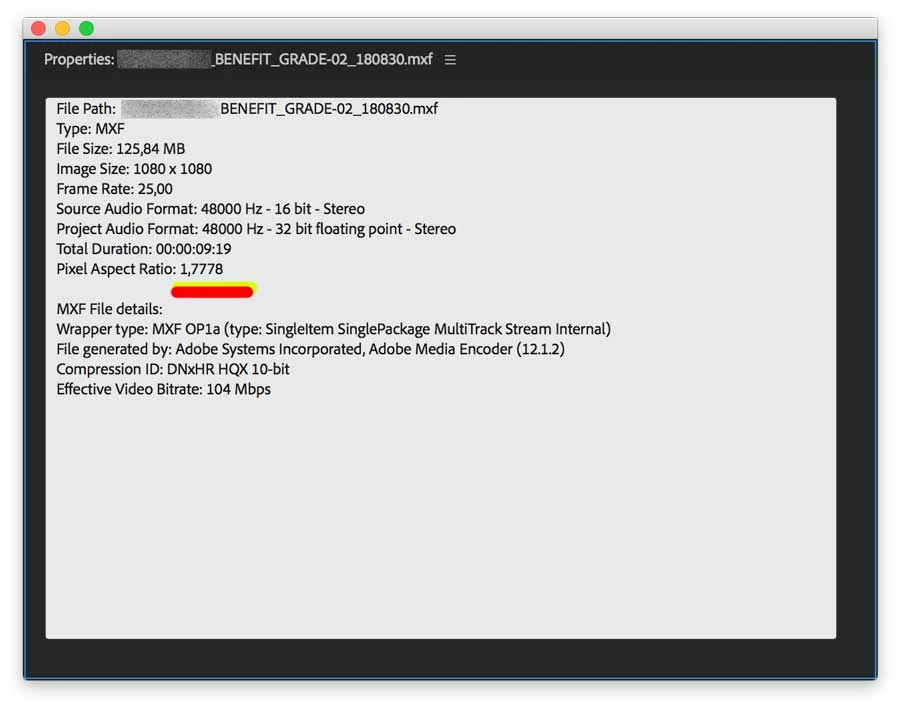

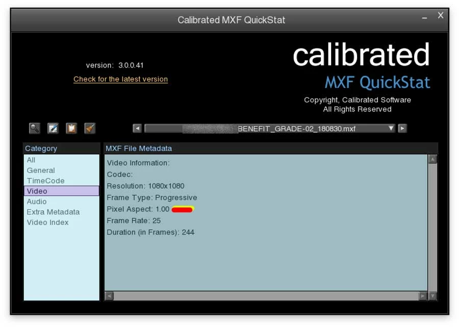

    Aug 30, 2018 3:38 PM UTC
    Same problem with Adobe DNxHR/HD HQX and square PAR/DAR output from Adobe Media Encoder. Metadata in MXF QuickStat (Calibrated Software) is 1:1 (correct). Metadata of Adobe and Interpret Footage in Premiere Pro/After Effects/Adobe Media Encoder is 1:1.78 (16x9). Have to manually set PAR to 1:1 and export as H.264.

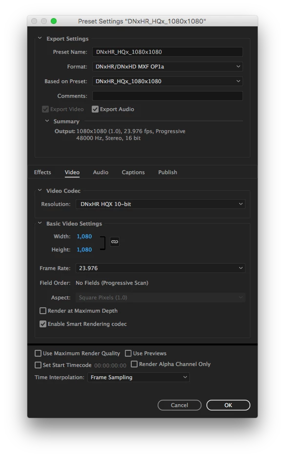

    Hi EvanS,
    Could you please also attach a screenshot of the Export Settings window?

    evans45721616
    Jul 27, 2017 7:56 PM UTC
    here is a screen shot.  I can post the raw text output of the .epr file if you like.

    Jul 27, 2017 8:33 PM UTC
    Thanks for sharing the screenshot, EvanS.
    I am able to reproduce this at my end (on my PC).
    The file seems to be square (1:1) when I am importing it into Premiere Pro.
    I need to further investigate if it is an issue with AME or something by design.
    I will keep you posted here. Thanks for your patience.
