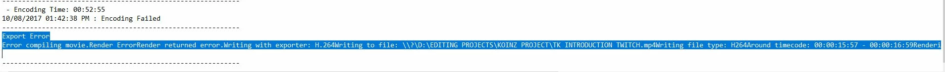

Oct 8, 2017 4:26 AM UTC
Unfortunately I'm having a similiar problem this is the error I keep receiving -
If anyone knows how to resolve this issue please help.
