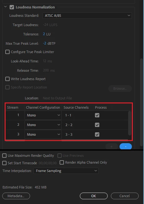

In Loudness Normalization section, you need to assign channels matching to your source file.  This is needed for the normalization to work in AME.
Since you use 8 mono channels, please add eight "Mono" channels there.  Encoding should work now.

I tried it with two mono channels, since only two are used. Channel 3 ~ 8 are "blank". The 8 channel format is just one of the requirements for that TV station.
It seems kinda odd, to have all the channels added, since I will only process the first two. Having only two channels added to the list makes the preset more compatible with other source formats.
