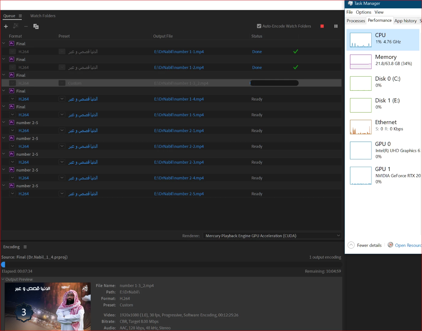

AME using 1% cpu/gpu
so i have a project in premiere that has AE projects work linked into it . the whole thing is mainly the AE ((not rendered)) but i have some cuts/logos imported into the timeline and on that timeline i have like 5 episodes of the same AE template i just change the name and add stuff in Pr with cuts . and when i added to the queue and clicked render i went home and got back today with ONLY 2 of them done and the rest are begin rendered and i noticed that the CPU/GPU are not begin utilized at all ... i tried software only ,cude everything resulted in the same deal no CPU usage. i tried turning off the native project import with no luck.
system specs (not that it matters) are :
I9 9900k
64GB ram
RTX 2070
x2 1TB NVME Samsung 970pro`s (( one for cache and one for the project)
5 replies

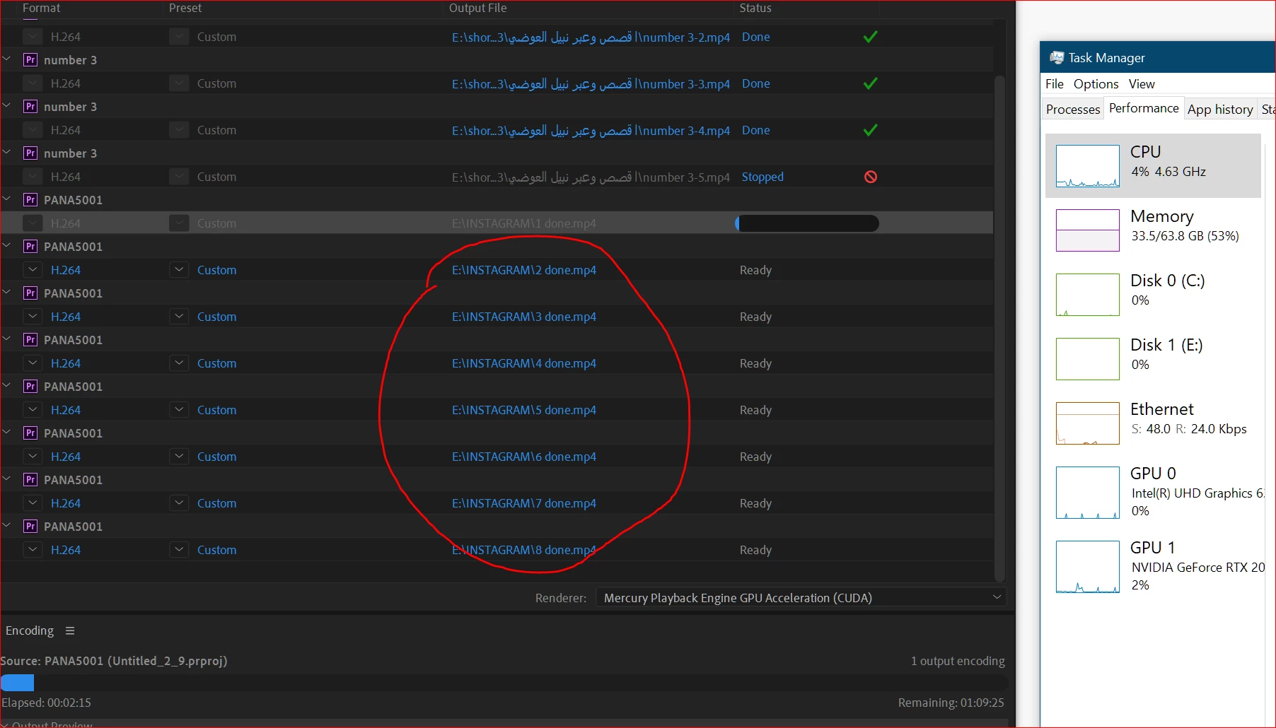

Jun 10, 2019 9:57 AM UTC
ok and update .... all of these clips ((image attached)) have ZERO AE anything in them all they have is some warp stabilization ( already done) ,color correction and a spining png logo .... same deal 1% utilization ... at least those are 1min clips they will only take an hour or so ...
