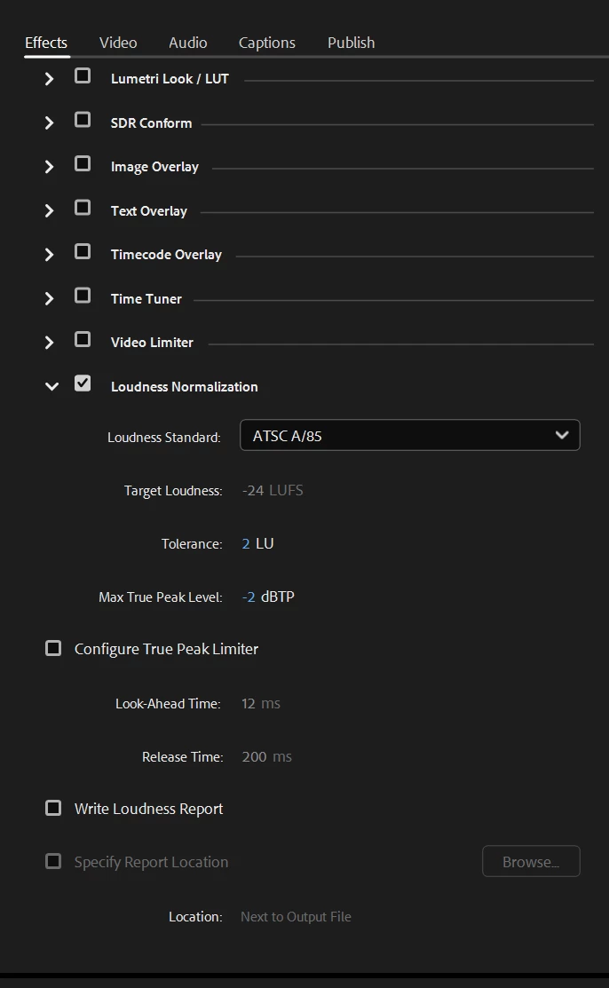

This should be possible with some caveats. Are the formats you're receiving these videos in all over the place or are they consistent, say ProRes 422? If your format supports Smart Rendering then you can bring the file into AME, and as long as the Output settings match the Source settings identically, you can enable the "Loudness Normalization" effect (see screenshot below) and your video should be untouched. Here's a list of formats that support Smart Rendering: https://helpx.adobe.com/premiere-pro/using/smart-rendering.html
I confirmed this by taking a 10 minute ProRes 422 clip into AME. Here are my results:
1) Using the ProRes 422 output preset with no other changes: 13 seconds. (indicating that AME checked out the video and used Smart Rendering to leave the file untouched).
2) Using the ProRes 422 preset and enabling the Loudness Normalization effect: 29 seconds.
3) Using the ProRes 422 preset, but unchecking the Match Source checkbox for frame rate and switching from 29.97 to 30: 1m18s.
4) For good measure, the same as above, but also enabling the Loudness Normalization effect: 1m41s.
These tests seem to confirm that if your output settings match your source exactly, and if that format supports Smart Rendering, then yes, you can batch process a bunch of clips and only enable the Loudness Normalization effect.
