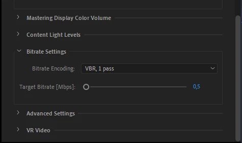

I'm experiencing the EXACT same problem. I have a few webinars that range from 40 minutes to 80 minutes in length. As you can imagine, the difference between 0,5mbps and 3mbps second is 500MB vs 3GB.
I have tried editing and exporting at different resolutions incase there is a standard I'm not conforming to, but it's made difference at all.
Just this morning, I upgraded to the latest version of Media encder (v14.3 Build 39) and it has made no difference at all. I've just run a test by encoding a 6min test file as H.264. These are my results:
Target bitrate: 0,3mbps resulted in a 95MB file. (Clearly this is an error)
Target bitrate: 1,2mbps resulted in a 55MB file.
Target bitrate: 3mbps resulted in a 137MB file.
It also makes no difference if I export from Media Encoder or from Premier Pro.

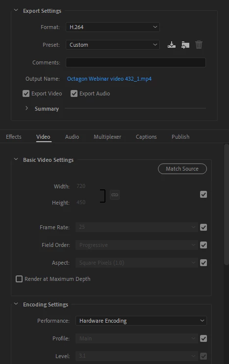

I've attached a screenshot of my settings as you requested from nadyam98391617 and tried different files and projects (though I've been using Media Encoder with an exported file, so there's no project settings or other potential conflicts that might come from Premier)
