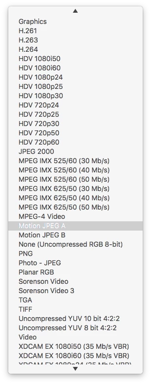

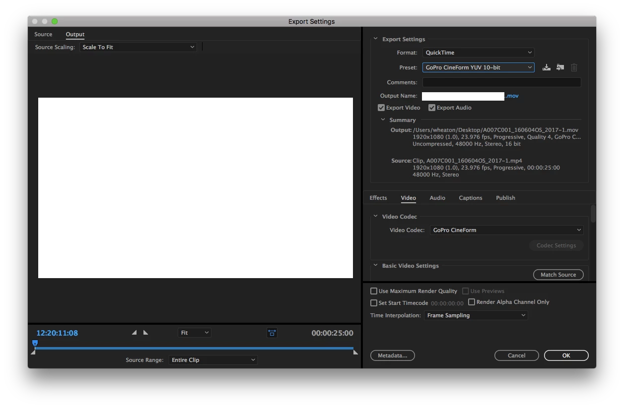

Warren Heaton
Warren HeatonCommunity ExpertCorrect answer
Jun 22, 2017 6:01 PM UTC
MJPEG as in Motion-JPEG A or Motion-JPEG B, right?
As far as I'm aware, Motion-JPEG A and Motion-JPEG B are only available inside a QuickTime file.
So, set the Format to QuickTime, set the Preset one of the GoPro presets, then go down to the video tab and change the Video Codec from GoPro CineForm to Motion-JPEG A or Motion-JPEG B.
If I remember correctly (I haven't used either of these since the mid-1990s), these are for SD fame sizes and require a field setting.
-Warren
Chris Panny
Jun 23, 2017 8:36 PM UTC
Hi Warren,
Thanks for your reply and screenshots. I didn't have quickTime installed on my Windows 10 machine because Apple no longer supports it. When I followed your steps for loading the MJPEG codec in Media Encoder, my list was much shorter with options. I went ahead and installed QT and after which, I did see the option for the motion jpeg codecs.
Big thanks for you help!

johnt53984649
Jul 1, 2019 4:22 AM UTC
I installed Quicktime 7.7.9 from here: Download QuickTime 7.7.9 for Windows
and these are the only options that I get in Media Encoder CC 2019 (as well as Premiere Pro CC 2019):
How did you get the MJPEG codecs to show up?  Am I missing a step?
