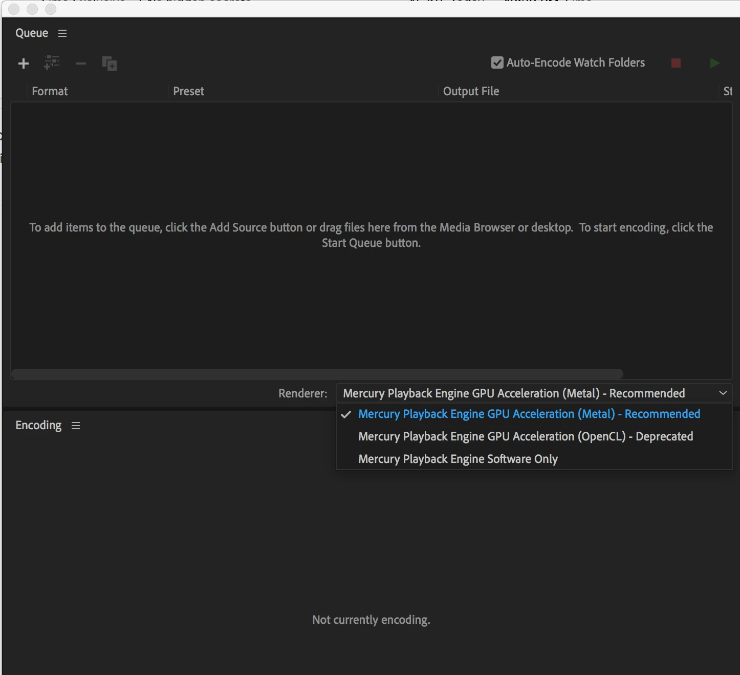

I'm running Media Encoder 2020 on macOS High Sierra on a machine with an NVIDIA 1080Ti card.
I'm using CUDA Driver Version: 418.163
with GPU Driver Version: 387.10.10.10.40.113
CUDA works fine in Media Encoder 2019 but it's not an option in Media Encoder 2020.
Has CUDA support been removed in CC 2020?

I'll try to regress (if possible) to an earlier version of CUDA and see if that helps. Please keep me posted on what you find in your tests. Many thanks!
UPDATE -
I rolled back to the previous CUDA version but it made no difference in the 2020 apps. CUDA is still not recognized. If CUDA is still supported, then this seems like a bug that can hopefully be fixed in the next point release.

I'm sorry to keep you waiting. I checked my resources. Lately, there have been few changes in the GPU support in macOS. Check out this link to know more: https://helpx.adobe.com/x-productkb/multi/upcoming-changes-GPU-DV-HDV-support.html
