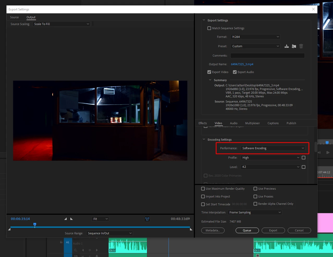

Here is a fix
Change hardware Encoding to Software Encoding.
https://youtu.be/EJ9dClm7XZQ

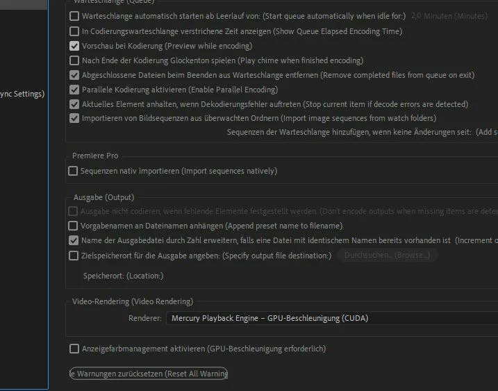

I played with some settings and I don't no why the error disappeared , hopefully for ever
In AME settings I unselected "Import sequences native"
see screenshot
can anyone confirme this

Hello all, I also had the same problem and I solved it by changing the render settings from Hardware encoding to Software encoding. I saw a comment in another thread that simply tells that it is related to the hard disk. I was working on a 50 mins project which has a lot of linked after effects compositions and that was the main reason. But this method solved my problem.
Jan 6, 2021 11:19 PM UTC
Hi
It may solve your problem but....
It is not a solution. Runtimes for rendering take much much longer than using HW coding.
As stated earlier this might not be acceptable for others and me
