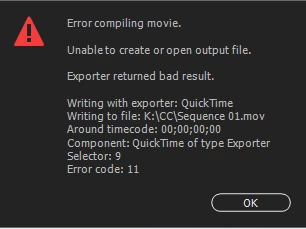

May 5, 2017 6:34 AM UTC
I have slightly different error code:
which occured to me after I wanted to export h264 in QuickTime.
I had a few clip to export in various codecs wrapped in QT and all worked but this one. I spent two days on finding solution but I got it: I changed the export location from my regular hdd to... system ssd (C:/ drive ...). Don';t ask me why - it magically worked. Then I could export all other clips to my hdd location (K:/ drive) without any problems :/
So try maybe exporting just to C:/ for this specific codec
