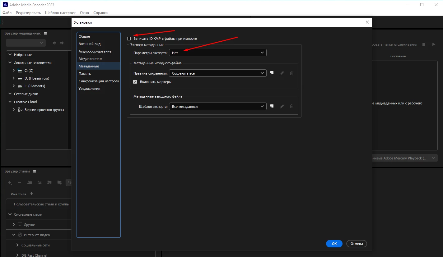

You mentioned a pretty old custom preset. Does it also happen with system presets? Also what are the metadata settings? What happens when you disable metadata creation?
