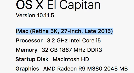

I am editing using Premiere Pro CC 2017 on an Imac , details below.
