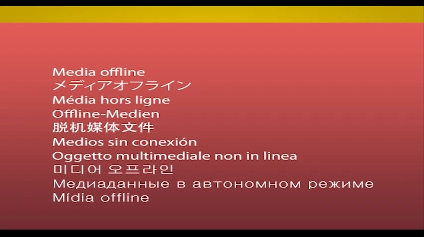

Exporting timeline with open captions export as "Media Offline" from Media Encoder
This seems to be an old issue that I hope someone as solved. I am editing in Premiere Pro 2020 exporting translations, 12 different languages and 12 separate sequences. I have aligned all of my imorted srt files and set them up to export and upload through Media Encoder but the screen is covered with the "Media Offline" error. Exporting one by one from Premiere is to time consuming of an option. Has there been a solution for this problem after all these versions?

Feb 11, 2020 8:58 PM UTC
thanks for the response, AME is importing sequences, i do have an AE Dynamic Link in the sequence but the media offiline is all throughout only where the caption exist. i am using the latest version of 2020 from the suite on a Mac. It does export fine when done directly from Premiere....
