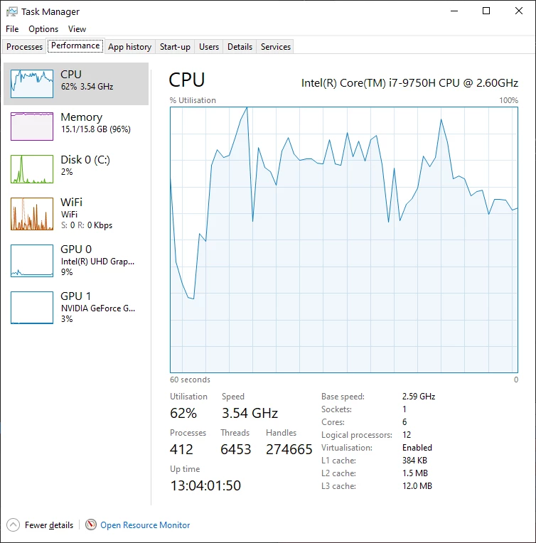

Hi David -see screenshot attached. I see that my nearly all my memory is being used and that there is hardly disk space to work with. Neither come as a surprise. I did the keying as you suggested and cropped it as much as possible. The filesize of the ProRes4444 .mov was indeed significantly smaller but I would have thought rendering times of my final AE project were going to be a lot shorter, and that is not quite the case. Maybe my system is just too weak.
Apr 14, 2021 1:13 PM UTC
Yeah, RAM is definitely a bottleneck here. When you fill up your RAM you start to offload things to virtual memory, which is a file stored on your hard disk. RAM is significantly faster than hard drives, so this process of offloading or "swapping" from RAM to your hard disk and then recalling those files from your hard disk is slow and is surely contributing to your speed issues.
So unfortunately, yes, this is a case of your system not having enough resources. I can't say how much faster things would be if your company were able to double your RAM to 32 GB, but any time you can remove a bottleneck where you're utilizing close to 100% of a specific resource, you should see performance gains.
