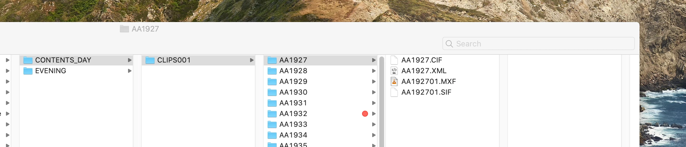

I have footage from a unknown camera (might be panasonic).  I want to transcode all media to ProRes 422 and have that worked out, but the camera media is buried in folder structures and I want an easy way for Encoder to see it so I can queue it.  I don't want to have to go to each folder and find one media file, want to see all media files in encoder.  Also want to make sure I have all the metadata I need.  The media is a .MXF file structure below.

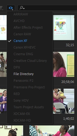

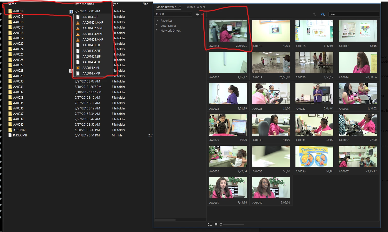

But that's what the Media Browser is for. Take a look at the attached screenshots. This is Canon XF footage, and just like yours, there are individual folders for each clip. In the red outlined area on the left you can see the contents of that folder contain multiple clips (split at 4 GB each) which make up the actual recorded clip. On the right side that one folder displays as a single clip. The rest of the folders each display as a single clip in the Media Browser.
If you navigate to the folder of all the clip folders and you do not see what I see, then click the blue eyeball icon at the top, on the left of the search bar. The second screenshot shows the different types of file structures that are supported, and if your folder structure is intact and supported (which Panasonic P2 is) then you should see a clip list. If File Directory is selected then you should switch to the other option, if there is one.
Feb 25, 2020 9:56 PM UTC
Thanks for the reply.  I don't see what your seeing, so that's probably the issue.  I did try and change the File directory to something else but it wouldn't let me.  Do you think I need to down load a camera plug in?
Feb 25, 2020 10:27 PM UTC
I did add the Canon plug in but I still can't select any option other than File directory from the drop down menu.

The folder structures of media recorded to cards is important to keep intact, and digging down to the MXF file like in the screenshot above is actually not the best way to see your clips. If you have a clip under 4 GB then this isn't really a problem, but once a continuously recorded clip exceeds that size it will get split up into multiple files. Use the Media Browser panel inside of AME or PR to view these clips properly, the same way they were recorded in the camera.
Feb 25, 2020 5:10 AM UTC
Hi yes ofcourse, I am always injesting from within AME browser, the screenshot was just to show that each .mxf is buried within many files.  I am after away, within AMA, to look at just the .mxf so I can batch load into que rather than dig into each folder for one .xmf file.
