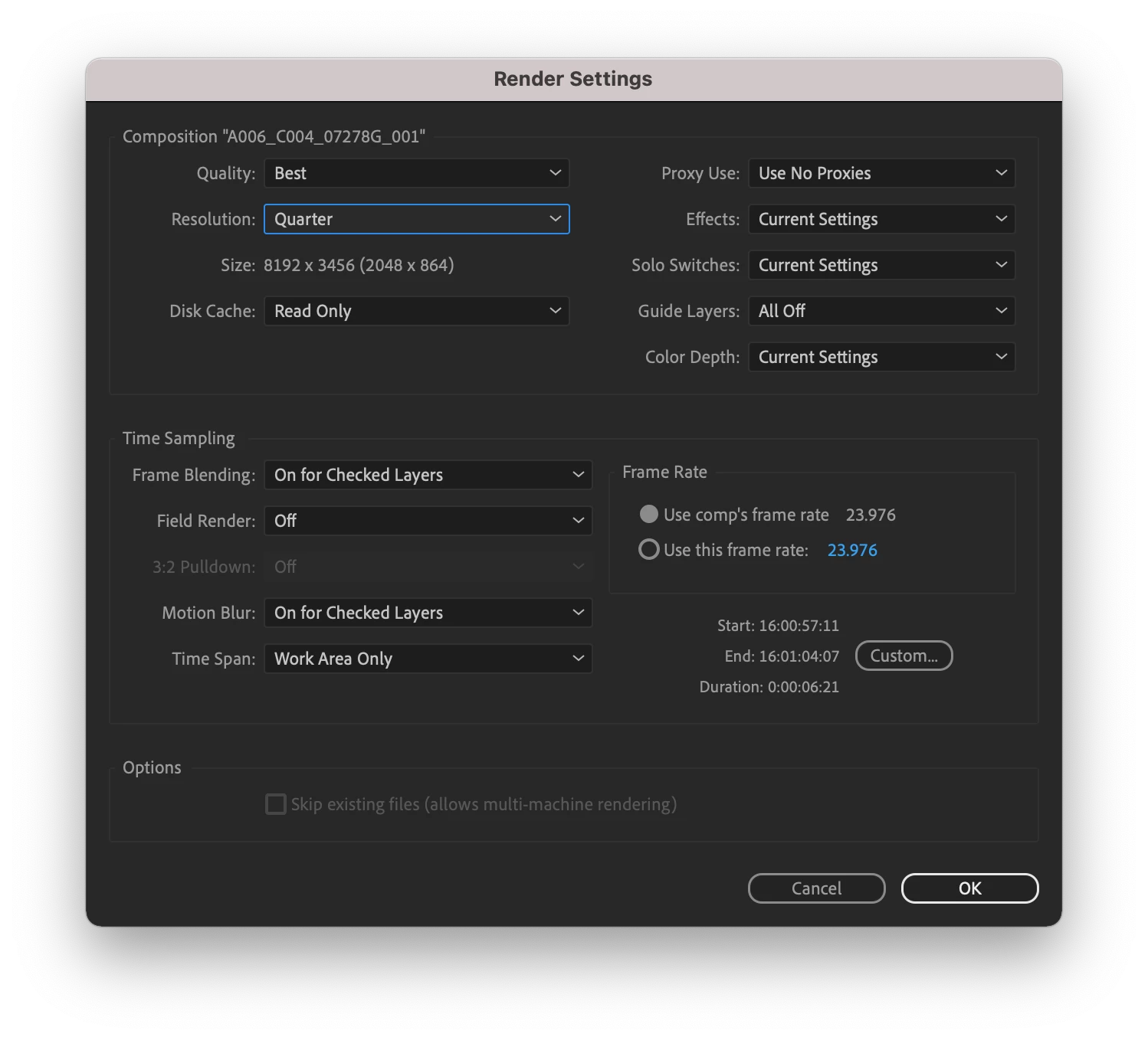

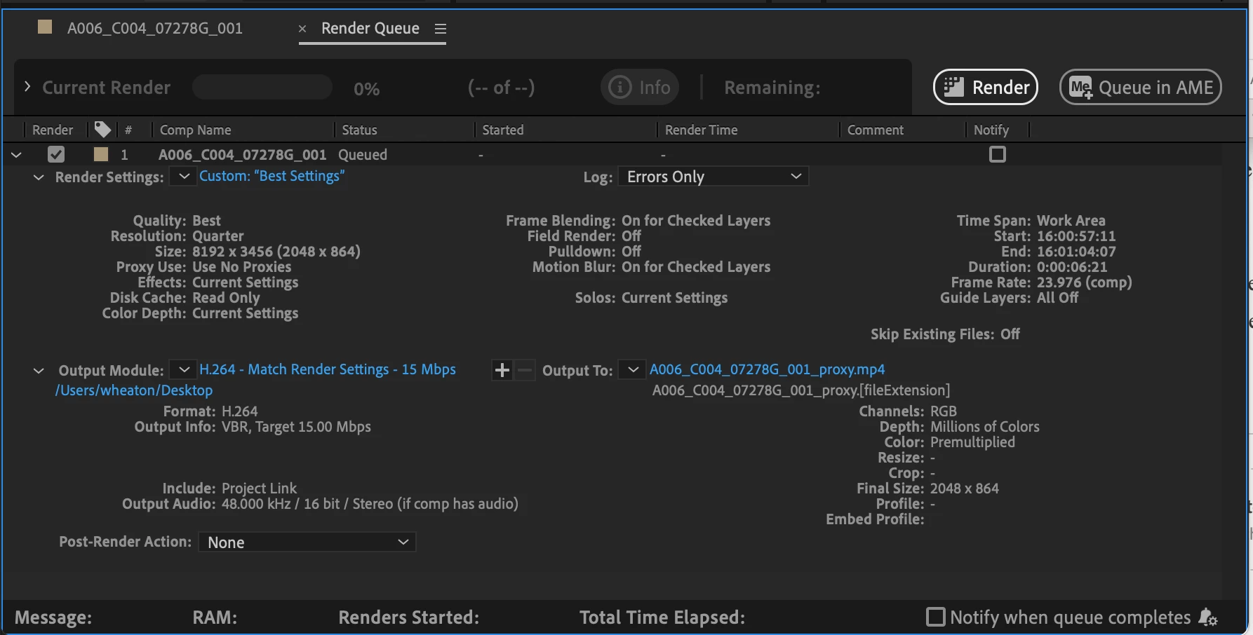

If you create the proxies in After Effects by adding each clip to a Composition (right-click > New Composition...) and then adding the Compositions to the Render Queue, you can change the "Resolution" in the "Best Settings" Render Settings Template from Full to Half, Third, or Quarter.
The result is a 50%, 33%, or 25% frame size for the rendered file.
The modified Render Settings Template can be saved and applied quickly to multiple items in the Render Queue or set as the default Render Settings Template.
If using the After Effects public beta (version 23), you can use the H264 Output Module Template.
You'll want to be sure to append "_proxy" to the Output To filename.  A custom Output To template can be created to quickly apply this as well.
