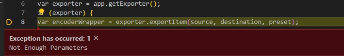

Hi guys,
I am currently trying to write a script in vscode using the ExtendScript extension. I have successfully connected to AME, confirmed by sending through an alert. Every time I try to run the sample code from this guide: https://ame-scripting.docsforadobe.dev/guide/index.html I am getting an error in my code , see the picture attached. I am posting here hoping someone can push me in the right direction.
AME Version 22.1.1 (Build 25)

Do you have tried to use all parameters mentioned in the function https://ame-scripting.docsforadobe.dev/reference/index.html#methods-3 including the optionals?
....exportItem(source, destination, preset, false, false)

Hi Sven, Yes I have.
