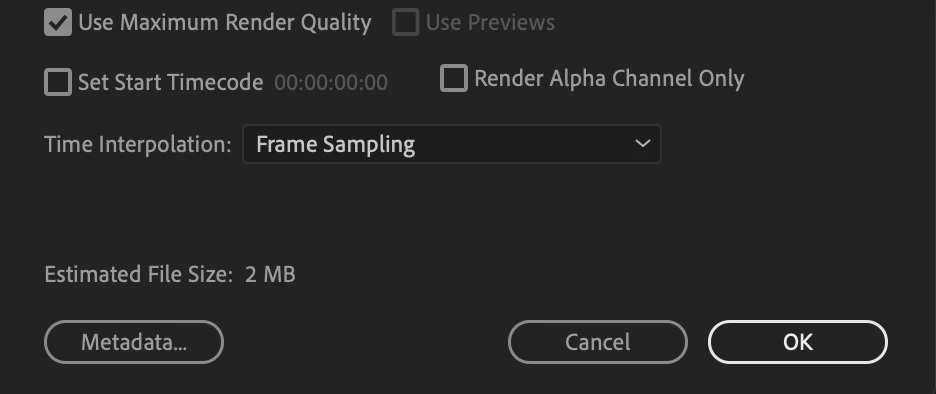

    This is a traditional film-to-video process called a 3:2 Pulldown, where frames are processed to fill up the same amount of time at the higher framerate. If you want to learn more of the technical details, take a look at https://www.extron.com/article/32pulldown
    AME can come up with new frames, but it depends on your Frame Interpolation settings:
    The avilable settings are:
    Frame Sampling: Frames are duplicated on an even interval to fill up the frame difference. Tends to be the safest setting with only slight frame jitter introduced.
    Frame Blending: Frames are time-stretched out and faded together. Movement may be smoother but at higher frame rate conversions can look fuzzy.
    Optical Flow: Creates new frames in a process similar to Photoshop's Content Aware tools, where tween-frames are generated. Works best for slow-motion or other footage where there's less change frame-to-frame. Can badly morph footage that has quick movement, and is more render intensive. If you're interested, check out https://theblog.adobe.com/optical-flow-time-remapping-tips-tricks-for-best-results/
    I'd recommend trying samples with different settings to see what works best for individual cases, but I usually stick with the default Frame Sampling because the visual difference, as you've found, is minor and less distracting.

    Interesting read. So the Frame Sampling setting is actually the same method as the 3:2 pulldown method? Very clever!
