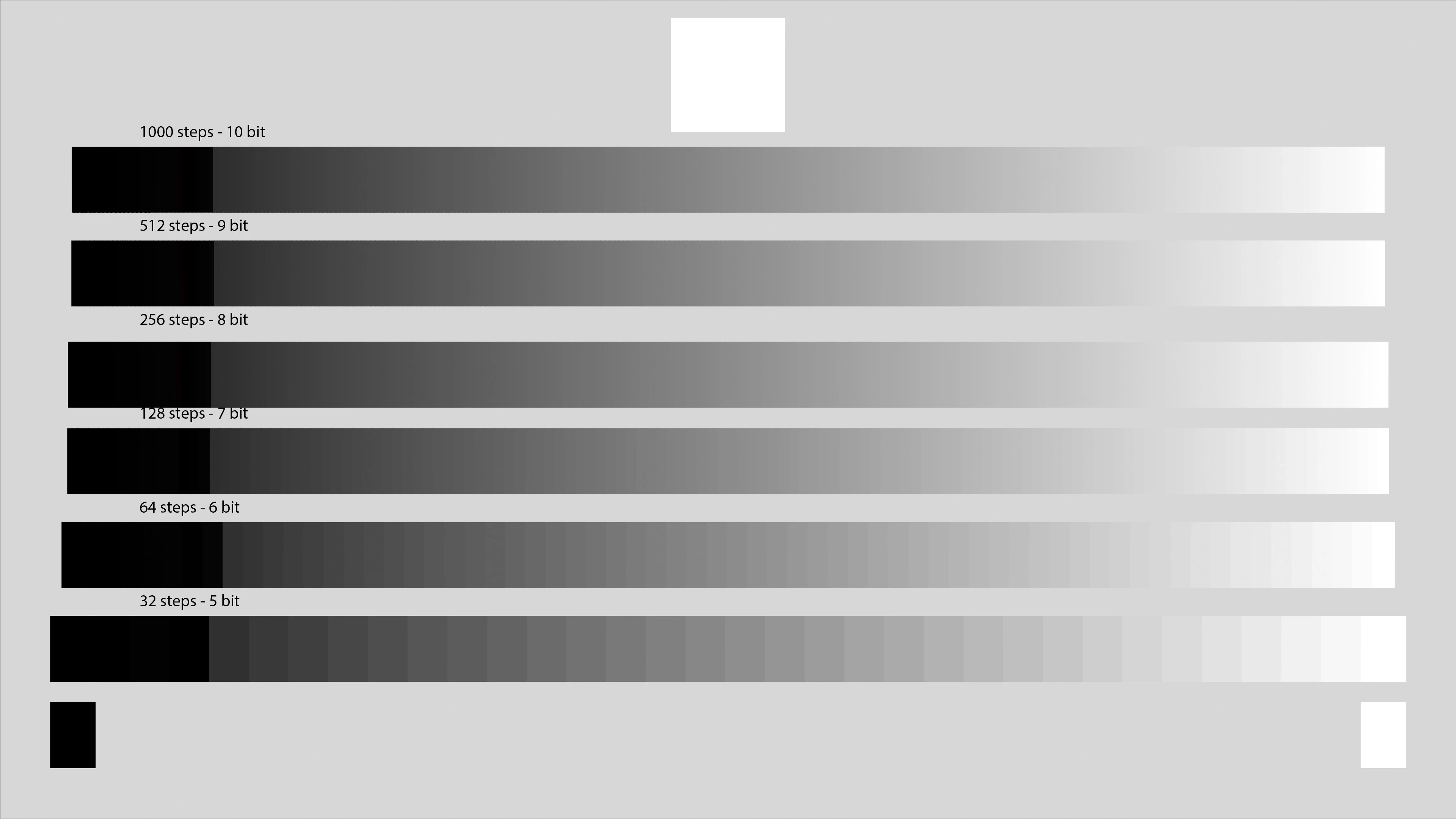

Source comp in AE:
This was made from an Illustrator file, when I did a blend with the specific number of steps (Blend maxes out at 1000 steps, so I couldn't do 1024 for 10 bit). Just note that there is more and more banding the further down you go in the chart.

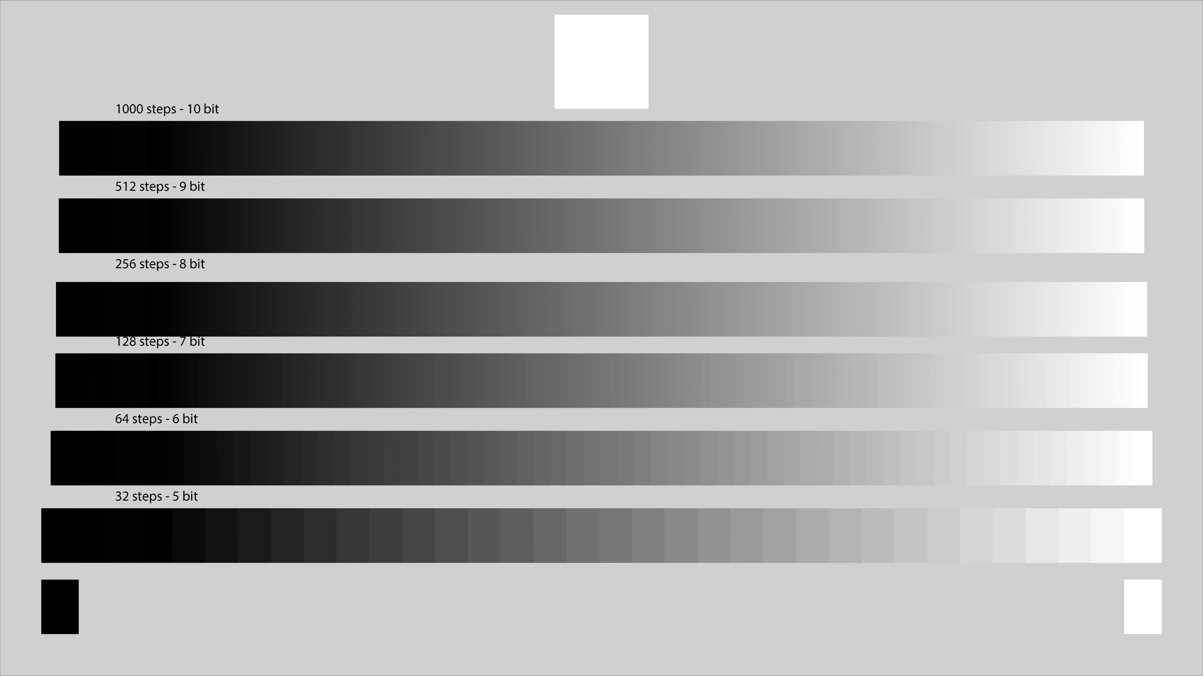

If I output enable Main10 (gives me 10 bits/channel instead of default 8), and enable Rec2020 and render it, I can get this:
It is clipping the blacks, but OK, that's potentially resolvable with an Adjustment Layer. We'll deal with that another time. But my 8 bit gradations are still nice and smooth, so far so good.

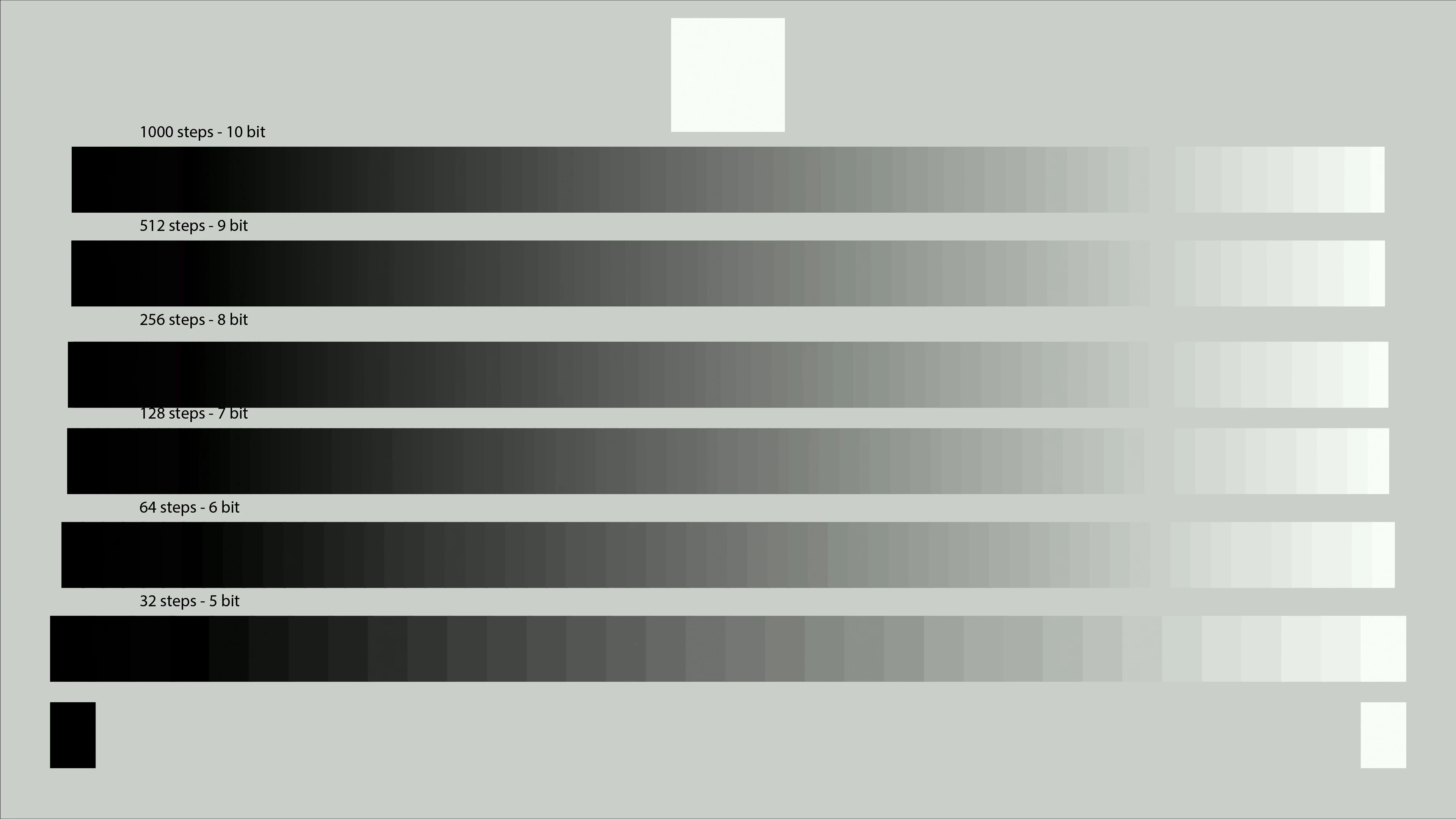

Here's what happens when I take the exact same setting, and turn on the HDR switch:
Notice I now have banding where I didn't before - the top three bars that were smooth before are now in discrete steps.
If you look carefully at the 128 steps - 7 bit bar (the one under those words), you'll see some inconsistencies - it isn't a smooth blend. There are a lot of these inconsistencies, where the width from one step to the next varies every few bars. 6 bit, with 64 steps, seems to be OK, so I'd say I'm getting between 6 and 7 bits of detail out of this.

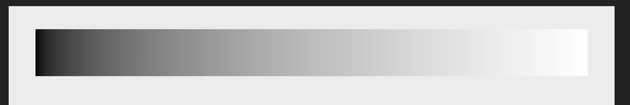

here's the source (screen grab from Premiere):
4K UHD material - matched source
4K UHD material with Main10 (10 bit output) - matched source

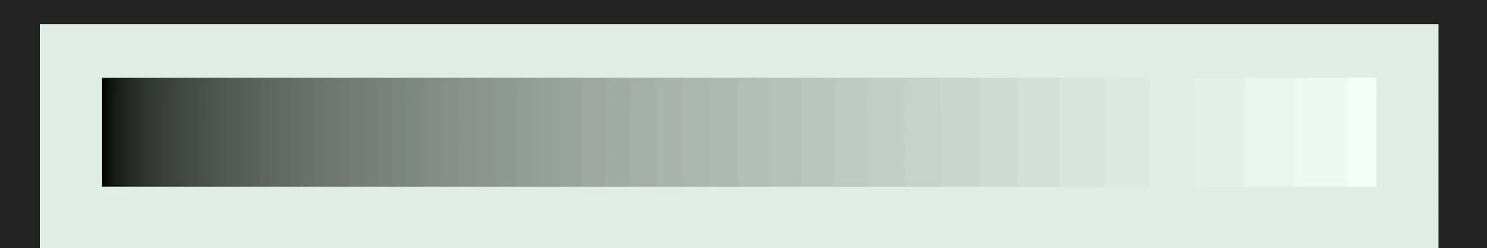

4K UHD 10 bit Rec2020 - a SIGNIFICANT gamma shift (this from HEVC file placed into Premiere):
...and here's the Rec2020 HDR:
a LOT of banding and a shift to green. Hmmph.
