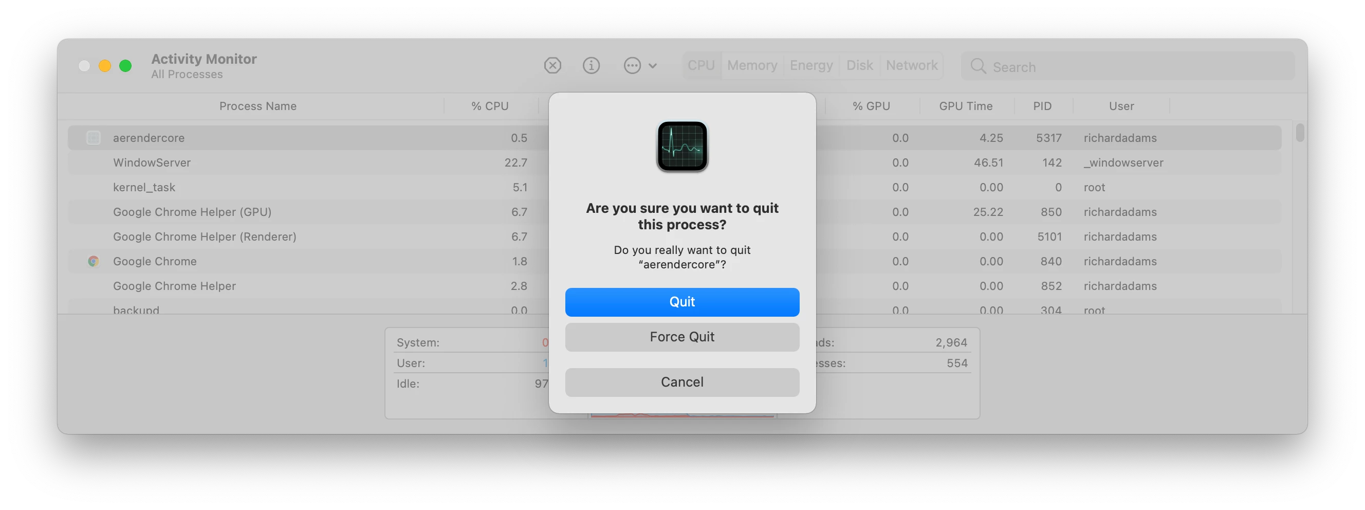

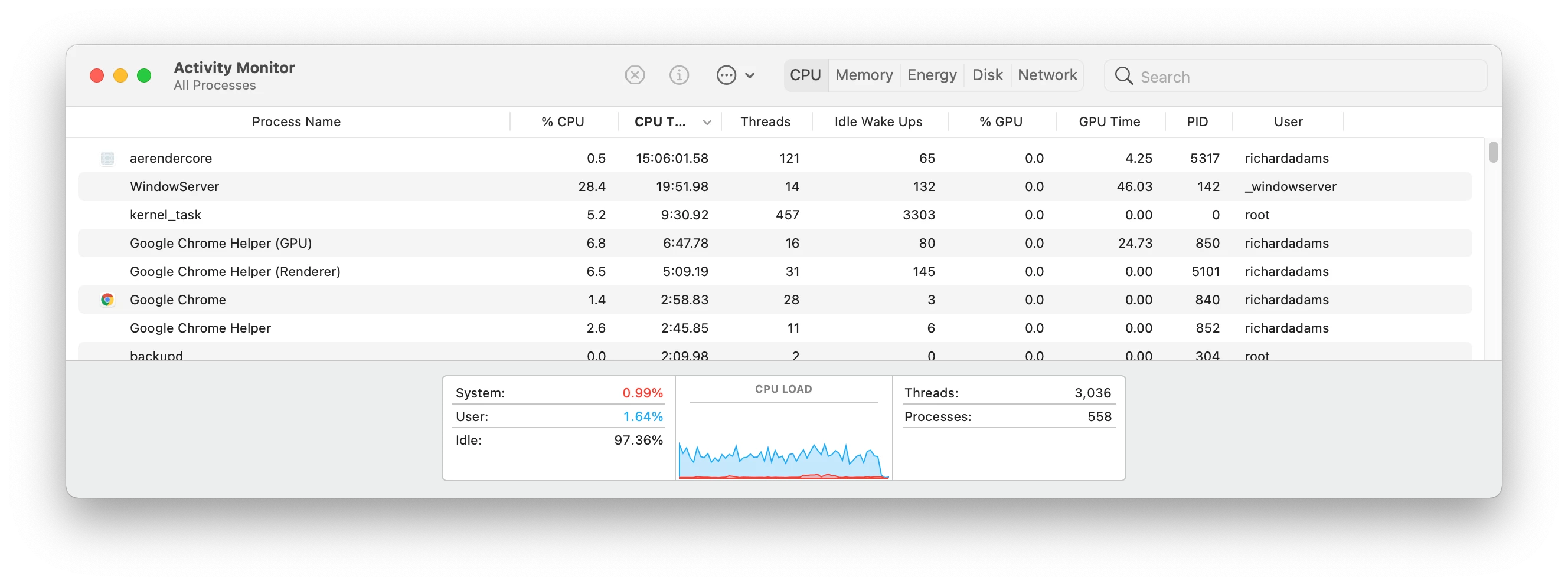

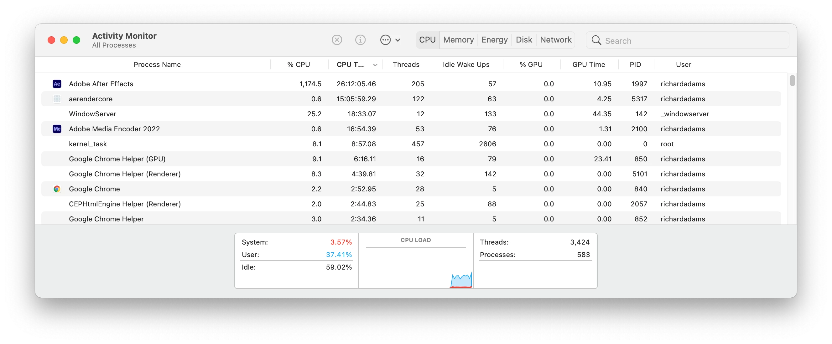

But I wondered if maybe there was something wrong with the SSD itself that could impact this problem and I used Disk Utility to have a look. I started with running First Aid on the SSD. It would not unmount for the first aid, there was an application still using the drive. Looking at Activity Monitor I noticed “aerendercore” was (Not Responding). Although both Ae and Me were closed, there was a remnant of the render remaining in the CPU’s activity. It is possible that quitting Me when the render froze, did not quit all the processes associated with the render. I forced this process to quit and ran first aid, the drive was fine.

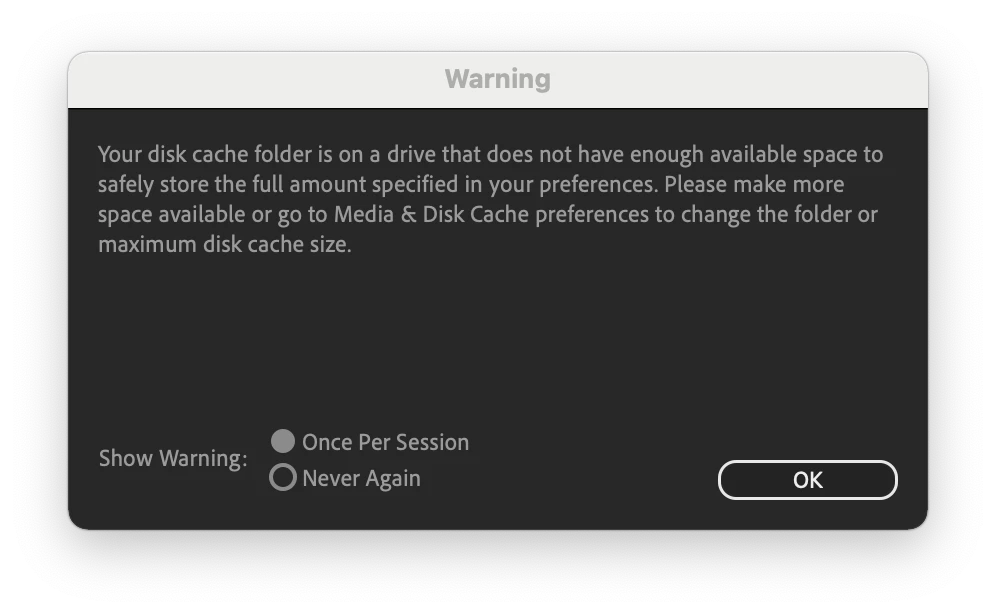

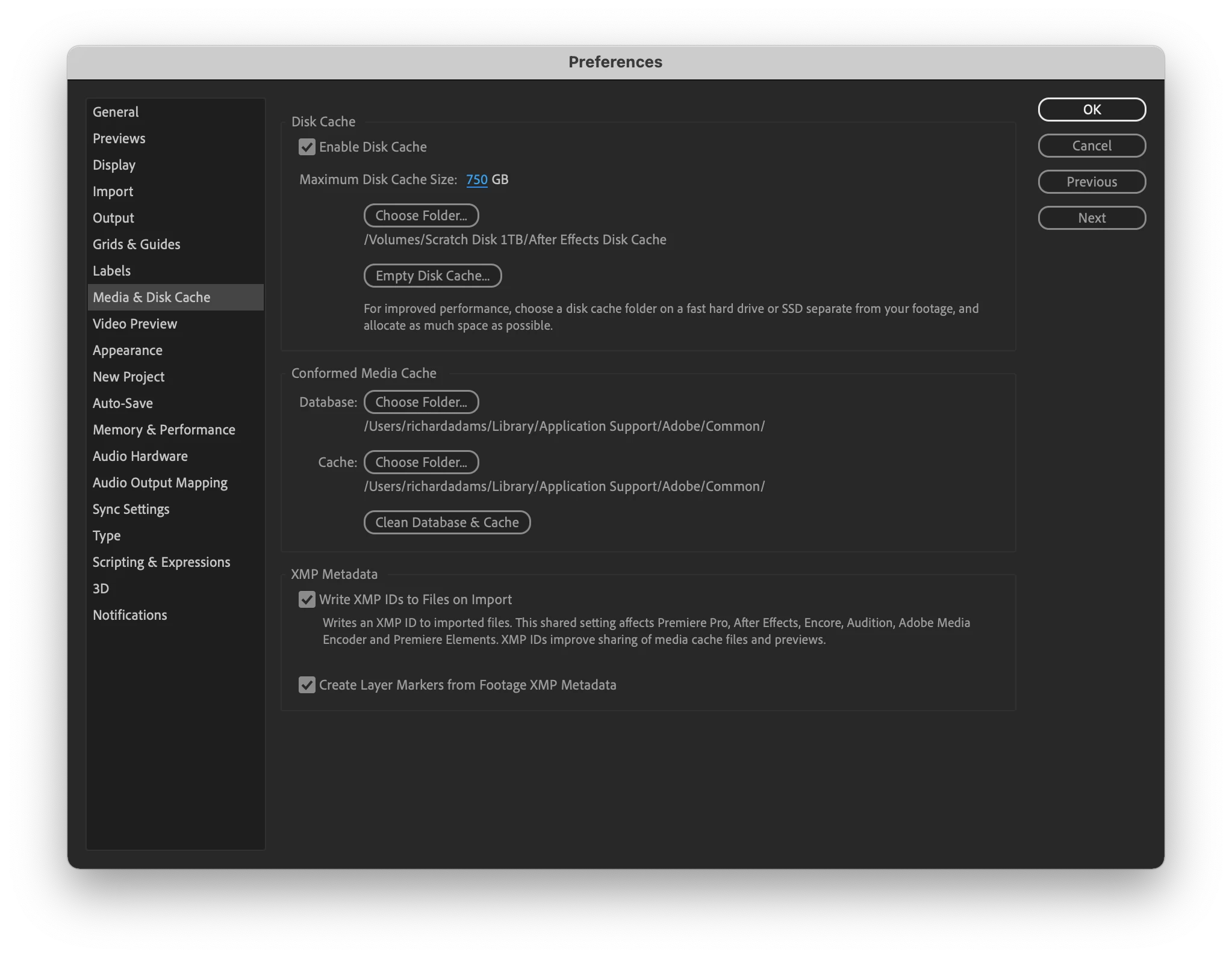

I reformatted the SSD scratch disk to remove all folders that the other apps may have used. I launched Ae and, in the Media & Disk Cache preference, increased the Maximum Disk Cache Size to 900GB since it was a 1TB drive. I received a warning that there was not enough space on the drive for that cache size. I tried 750GB, the error occurred again. Ae was happy when I set it to the original 500GB. I am not sure why Ae does not like taking all the space available to it, the drive was freshly reformatted?

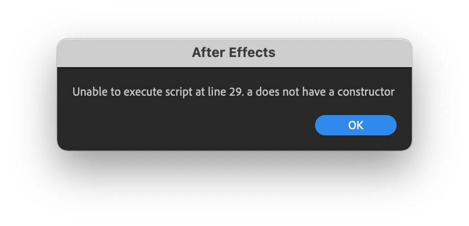

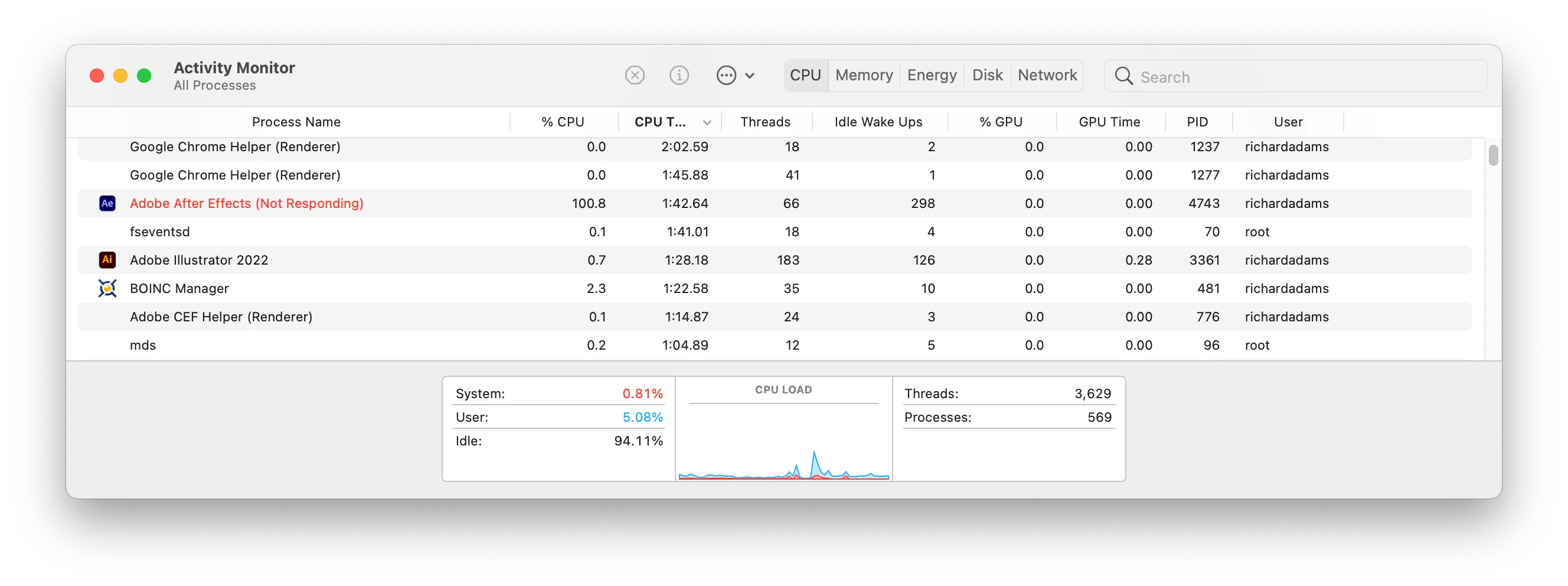

Once this was all finished, I restarted Ae. This time it seemed to take a really long time to launch and I could see the spinning beachball of death. I checked the Activity Monitor and it showed Ae as unresponsive. I waited a little longer and it completed the launch but returned an error “Unable to execute script at line 29, a does not have a constructor” I dismissed the warning and Ae started up but did not go to the “Home” screen to select the project I wanted to open.

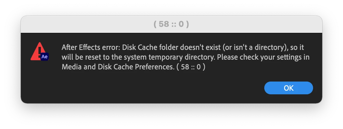

I decided to upgrade to the latest version of Ae 22.2.1 (Build 3). It seemed to start as expected however, it produced a disk cache error. It would seem that software upgrades do not remember the disc caches settings and I repointed this to the SSD scratch disk.

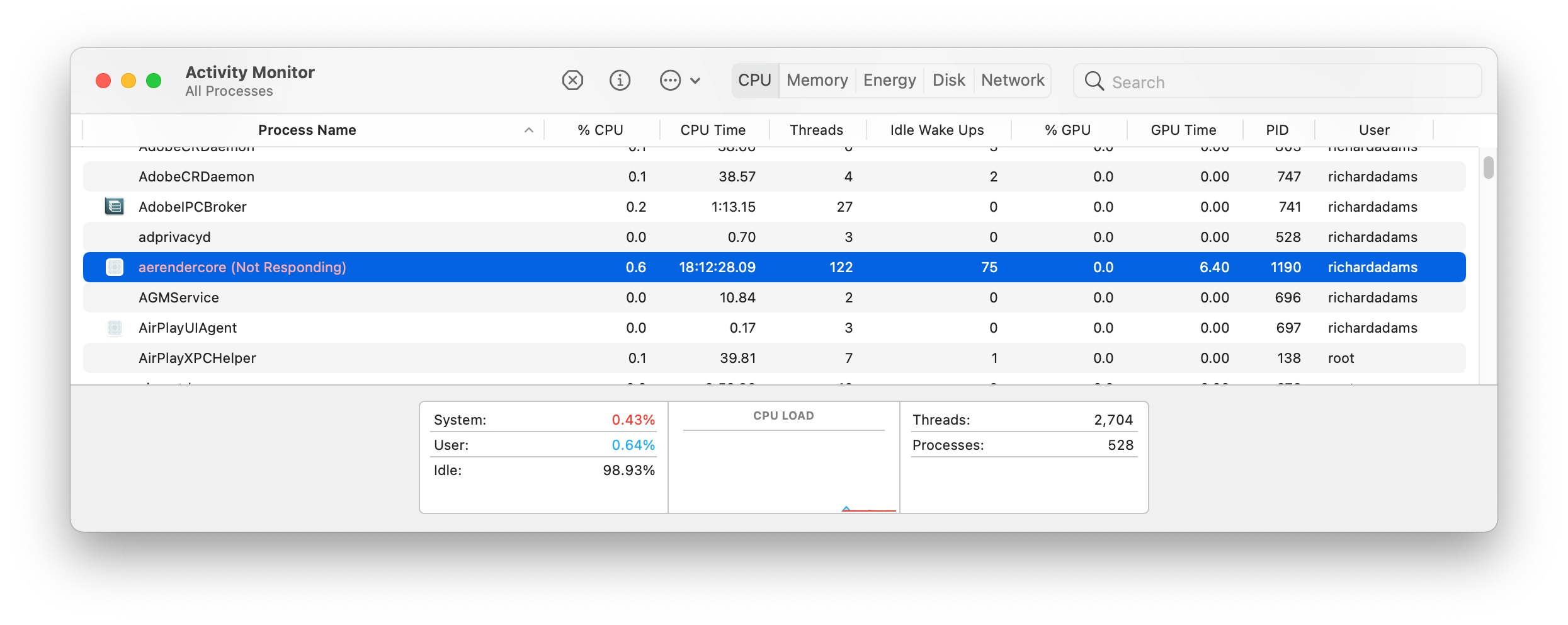

The Activity Monitor shows the “aerendercore” as functioning however I watched the processing time indicators and they did not change for 10 minutes before I ended the process.
I quit Ae and Me and the “aerendercore” is still appearing in the Activity Monitor.
