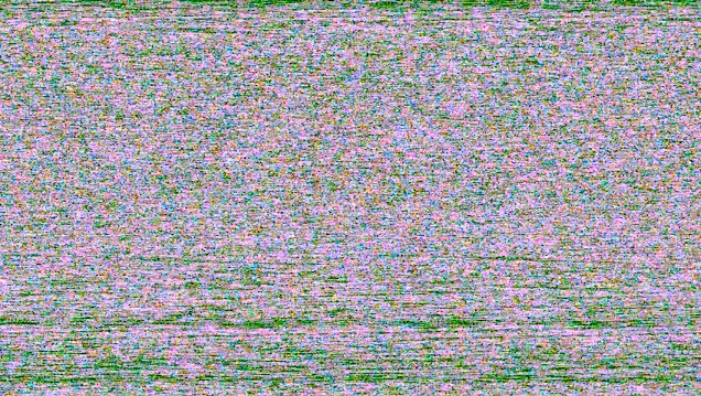

    I have arrived at a complete new level of puzzlement. A sequence which AME did render well on Windows get some interesting effects on my Mac like this:
    This part should look a bit different, trust me on that. The source is an ProRes422 movie, for some reason it's 960x720 with aspect ration of 1,333. So I created a new sequence having just this part in it, chose ProRes 422, 1280x720 square, replaced it in the sequence and it rendered just fine. Which is kind of odd, since the sequence has the settings 960x720 aspect ratio 1,333. Whats even funnier, on Windows I do not have that problem. There it gets interpreted correctly. All of that, and Playback in PPro is just fine, regardless of the OS or the spatial resolution of just that clip. Somebody can enlighten me why that is happening? I do guess that AME does have some problems with different Codecs and/or resolutions in a sequence - even more if both is different - which it shouldn't..
    Message was edited by: zikade
