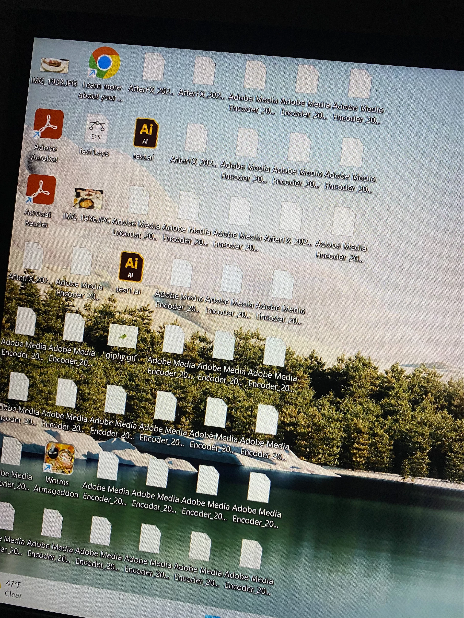

Same here. I am on an Asus ROG with Win11. I updated all my apps yesterday, and restarted my computer few times. Encoder still wasn't working, see the attachment of how many times Adobe attempts and fails running the program. Uninstalled the Encoder again, reinstalled. I gave up for 5 hours, checked back and magically fixed I guess and all good for now.

Same issue here. Nishu advised me to delete any plugins other than dummy.txt and I still can't open it.
I've installed and uninstalled multiple times, downgraded to 2022 and upgraded back to 2023. It is just so frustrating.
I'm glad yours fixed itself.
