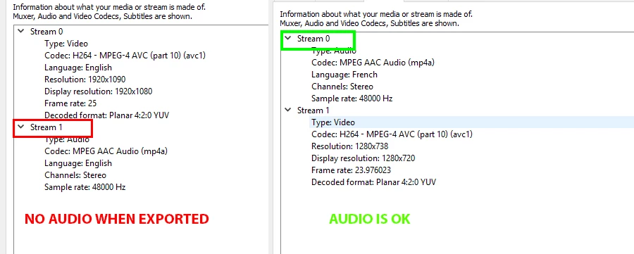

I've having the same issue with my end, Mac OSX latest update, Adobe CC apps latest updates.
A file which VLC tells me has the following Codec info
yqe8No
so as another user says the Audio track is in Stream 1 yet isn't exported with audio!

Dec 6, 2016 10:36 AM UTC
Same here. Audio is not presented in the exported files.
I couldn't resolved the issue. Tried all 3 options and re-installed AME.
It's only happening on some files. So I'm assuming that the audio track of the source isn't picked up in some cases.
The CODEC properties are similar BUT the working source files has the AUDIO STREAM "0", if the AUDIO STREAM is "1", NO AUDIO. (Info from VLC Codec properties)

Under the same location you deleted folders "Media Cache Files" and "Media Cache Database", could you also remove another folder called "Peak Files"?  Does this make any difference?
I have similar files with video in steam 0 and audio in stream 1.  There is no issue with those files.  This could be file-specific.  If removing those folders and clearing preferences don't help, I may need to ask you to send me your problematic file next.
