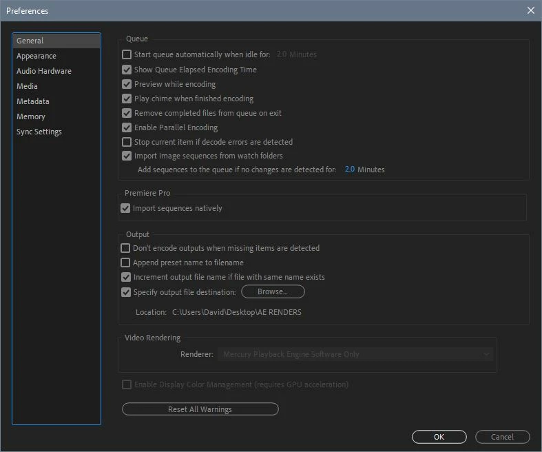

Preferences - Video Renderer - GPU Unavailable
Thanks in advance to anyone who can offer advise here. Cloud version of Media Encoder, noticed the option under PREFERENCES for RENDERER is greyed out and defaulted to software. This HP Z820 running Windows 10 has three Nvidia GTX 1080 Ti GPUs installed with the latest drivers installed. I just reinstalled the latest drivers to eliminate a bad install. I assume the 1080 Ti is more than enough for the GPU requirements? Adobe Photoshop preferences allows for GPU hardware acceleration to be set to maximum for GPU and works fine. Any ideas?

I'm not sure it's an OpenCL issue. That doesn't make a lot of sense why you can't choose CUDA since they're separate options. I'd check out making a new test user account and seeing what happens. If you can choose one of the GPU options then you know your drivers aren't the issue, but it would be something confined to your local account.
