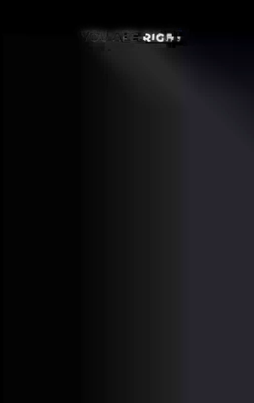

when I export video from Adobe PR and AE in mp4 format. It shows the glitchy screen stuck and audio only. I tried cleaning the cache and turning off hardware acceleration but nothing worked. The video size is just 500 kb which is also very strange, it should be around 15 to 20 mb. plzz guide  ...........

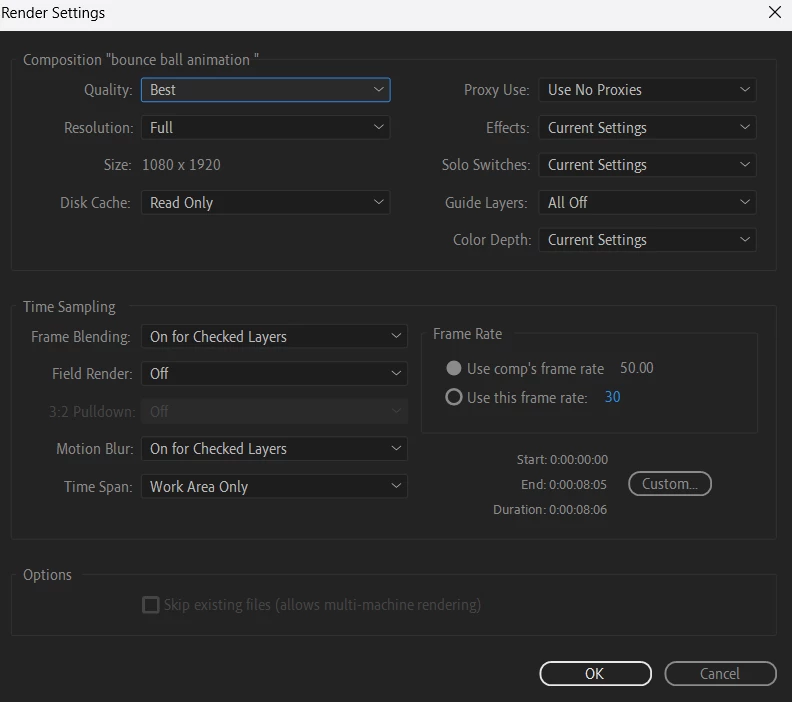

thanks peru it is working for premiere pro. Can you tell me how to turn off the hardware encoding for export in aftereffects?
