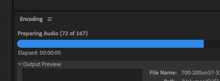

Jul 6, 2020 9:10 PM UTC
This is absolutely still happening. I have 2 audio tracks and it is preapring 167 of them. Takes about 20 minutes of wasted time.  

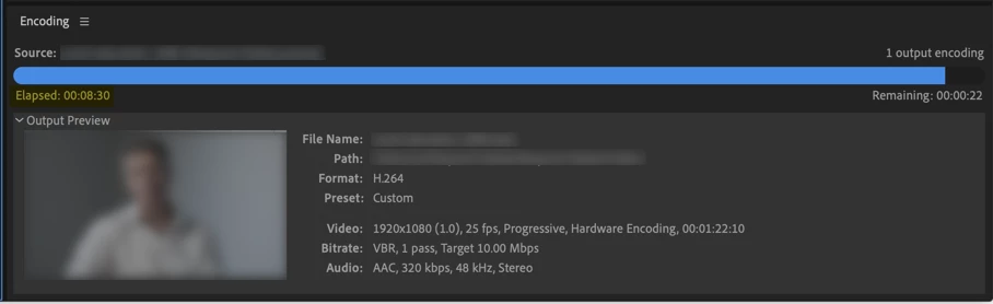

AJV Media
Jun 6, 2020 9:18 PM UTC
I have the same problem as well. Every time I export anything in Media Encoder it takes forever "preparing audio" before it starts encoding the video. Here's a screenshot of Media Encoder during export of a video with only 4 audio tracks:
And of those 4 audio tracks, two of them are empty. If there's any way to fix this, please let me know. I'm on Premiere Pro version 14.2.0 (Build 47) running on Windows 10.
