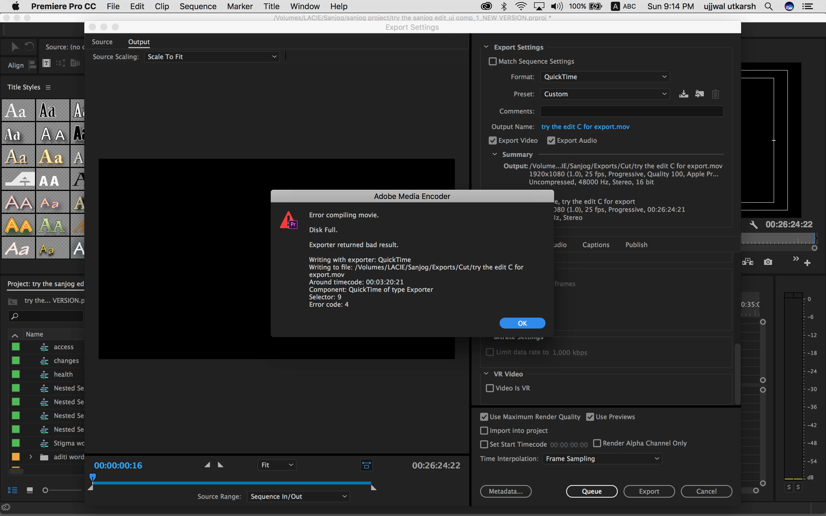

I have a timeline that is around 30 minutes long,
and though i am able to give out h.264 outputs, am unable to eXport pro res or uncompressed 8 bit files.
Weirdly the error being shown is off disk full which is NOT the case at all.
I tried in both the thunderbolt hard disk and the laptop hard disk too.
And I have more than 300 gigs available on the laptop hard disk.
The error is coming in both the Media Encoder and also directly from Premiere.
I am attaching the screenshot from the Premiere error.
The footage is from 5D.

    So, finally i think it did work, but there seemed to be a problem with multiple layers, sped up shots, and overlaying graphics and so on.  There was a portion of that timeline which was like that with really a lot of layers and so on. (there were about 20-30 layers there, i think) I eXported it separately and placed it there and then it did seem to work. (The same issues were happening with AfterEffects timelines - the ones that I had directly sent from Premiere- but then placing the eXports there directly helped, i guess that s easier for the computer to process) But it's really random, even after that once it again gave error, then when I put on an eXport of pro res with h.264 then it worked, and then again it didNT, and so on. really random. Finally, I doNT know after how many attempts it did work, but with a useless h.264 eXport with it. That s really weird as to why it should work when I am assigning two outputs and not one, or maybe it was just random.
