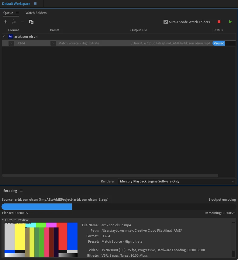

Hello there,
I am having an issue rendering after effects compositions on Media Encoder. You can see the problem below.
Any ideas regarding this problem? I am going mad.
Thank you so much.

Aug 28, 2021 4:00 AM UTC
Color bars are displayed when source footage used in the After Effects Comp is missing.
Open the After Effects project that contains this Comp, reconnect the source footage, and save.  Then, use Composition > Add to Adobe Media Encoder Queue to send the Comp to AME.
It's important to remember that After Effects links to media imported into the Project tab.  If you're not organzing your work such that the source footage links can be maintained, you can use File > Collect Footage from the File pulldown menu in AE to have AE gather the footage for you.  Maintaining the resulting folder should maintain your source footage links.  It's also worth mentioning that there are other dependencies that need to be available when you queue an AE Comp in AME like fonts and 3rd party plug-ins.

Aug 25, 2021 11:48 PM UTC
I appears to be paused.  Did you try clicking the green arrow?
