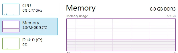

    Very slow for me too -
    Windows 8.1 i7 8GB RAM
    10 second AE clip with rotobrush taking 17 hours
    Reources on PC are not at max

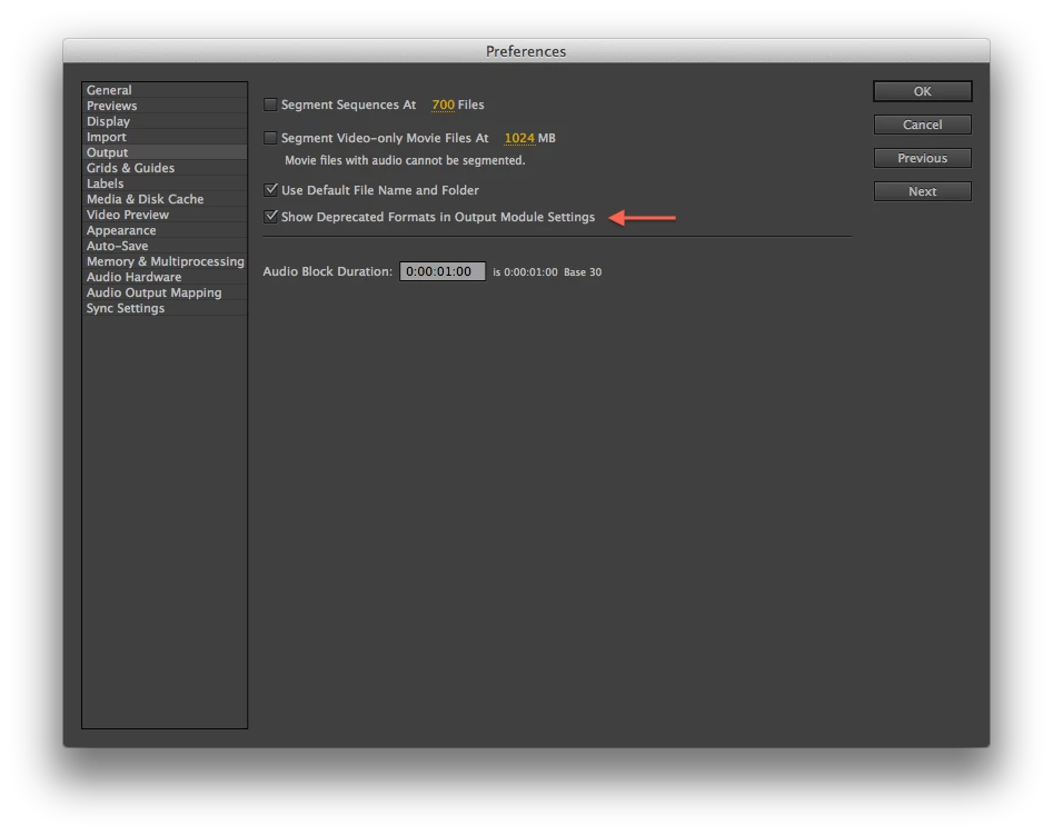

    The MPEG2, MPEG4, and H.264 outputs (and Windows Media) are hidden by default in After Effects CC but you can bring them back by turning on "Show depricated formats" in the Output section of Preferences:
    This will re-enabled these output choices in the Output Module settings menu:
    In general tho' you should use AME to export to these formats.  They were "depricated"  in After Effects because they're legacy versions of the exporters while AME uses newer versions that are still being actively developed.  Only re-enable them if you need to troubleshoot an output issue, like this one, or have older AE projects that are dependent on them.
